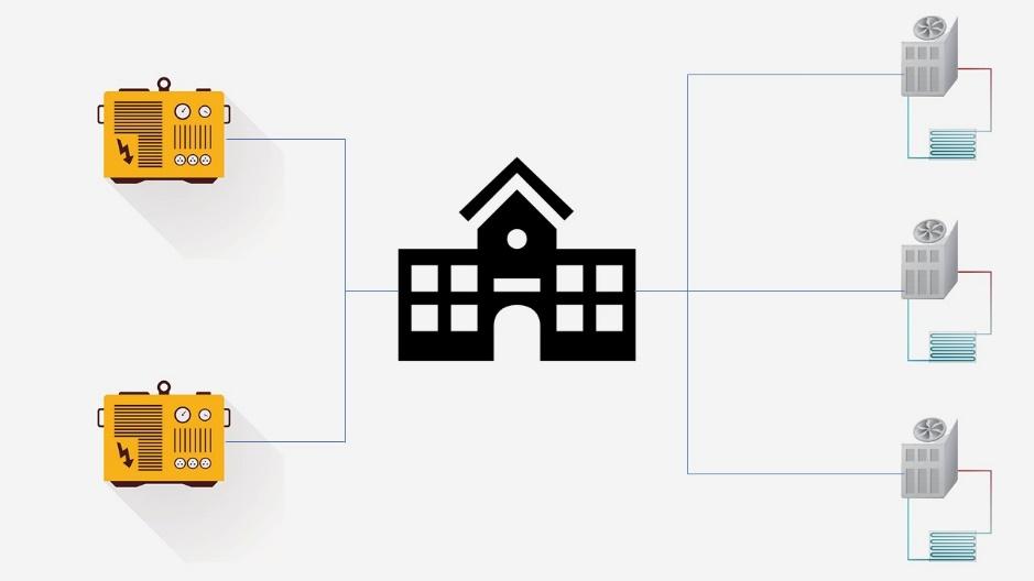

Take a look at the building in Figure 1 below. It is powered by generators, so it has two generators and three cooling towers. One generator is in regular use and the other is kept as a back-up. Similarly, two of the chilling towers run regularly and the third serves as a back-up.
This building is powered by generators and cooling towers, both of which have an emergency backup.
Figure 1. This building is powered by generators and cooling towers, both of which have an emergency backup.
All of the vital readings of various sections of the building, the generators, and the cooling towers need to be monitored around the clock. When one of the generators fails, the back-up generator has to start automatically, and the same is true with the cooling towers.
There is a lot to keep track of with this building. Operators and corresponding technicians should be alerted in failure events. The generators and cooling towers must also have a regular maintenance schedule. The process needs to be automatically shifted to the back-up units and alerts should be sent to the maintenance team.
This may sound like a job that requires a lot of manpower. But this is where a SCADA system can operate the complete requirements with just a couple of operators monitoring the system. This is the power of automating processes with SCADA. In addition to the requirements mentioned above, the water supply, gas supply, perimeter, and other surveillance requirements can be controlled using the same SCADA system without having additional operators.

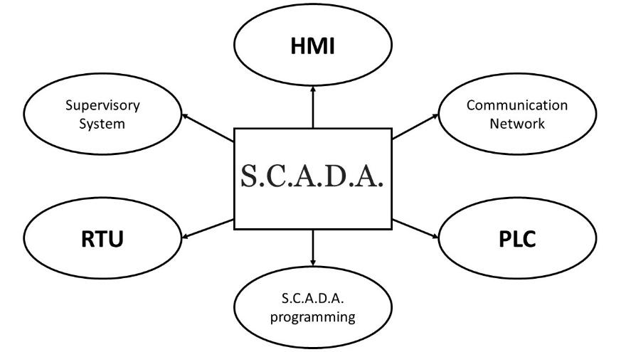

SCADA is a combination of both software and hardware elements that help to provide supervisory control over processes and data is transferred and stored in real-time. As you can see in Figure 2, a lot goes into a SCADA system.
different elements of SCADA
Figure 2. The elements of a SCADA system.
The common elements of a SCADA system are:
  • Master terminal unit (MTU) – The MTU can be a dedicated computer, a PLC, or a remote server that communicates with remote terminal units. The MTU is the heart of the system. All commands and data initiation originate from the MTU.
  • Remote terminal units (RTU) – RTUs collect information and manage processes in various field sites in the system. Actuators and sensors are connected to an RTU to gather information and manage various local processes. It receives control commands from the MTU and sends back information from sensors to the MTU. RTUs can be PLCs or other systems.
  • Communication Network – The communication network provides an information link between the RTUs and MTU. This can happen in various forms including coaxial cables, fiber optic cables, wireless signals like radio and Wi-Fi, satellites, and telephone lines.
  • Human-machine interface (HMI) – HMI is an input-output device that can be used to present data and input commands by a human operator. It can be in the form of a monitor with buttons or a keyboard or a touchscreen.
  • Programming - SCADA systems can be programmed according to the different needs to handle processes. SCADA programming can be done in programming languages like C or using a derived software tool.
