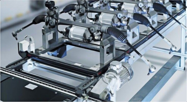

How Conveyors Work
A typical belt conveyor consists of a belt or geared by an electric motor. Pallets ride along the belt until a stop is activated. The pallet will slip along the belt until the stop is released.
A belt conveyor is prone to wear, requires scheduled maintenance, and is typically not very fast. The belt is usually driven by an asynchronous motor with a VFD (variable frequency drive), meaning the conveyor is rather on or not, but can also be driven with a servo for accurate positioning.
Figure 1. An assembly conveyor. Image used courtesy of Bosch Rexroth
Part tracking requires RFID tags on the pallet or some other way of tracking which pallet is in which station or location.

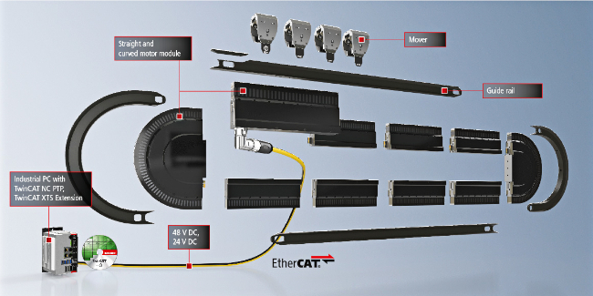

Figure 4. The modular XTS system. Image used courtesy of Beckhoff
The Beckhoff XTS system comprises track sections that connect together much like the train tracks you played with as a kid. The shuttles are interconnected to the motor segments and can only be removed by separating the sections. This system also requires a linear guide support under each section.
The system cannot take any perpendicular load to the shuttles. Much like the B&R solution, the track needs to be programmed through Beckhoff’s programming software.
