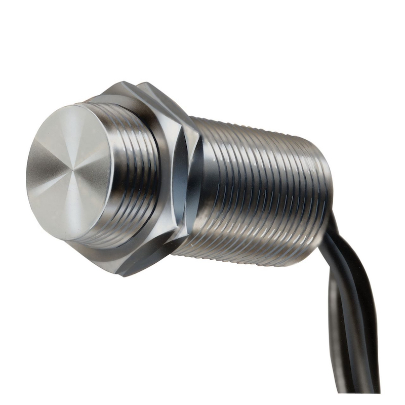

The 103SR Series Hall Effect position sensor. Image courtesy of Honeywell

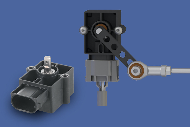

The RSA3200 Hall effect angle sensor. Image courtesy of Novotechnik, U.S.

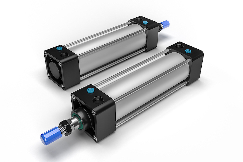

Applications for Pneumatic Cylinders
The location of a cylinder is vital to most robotic tooling, and a sensor is often needed to relay the position of the sensor.
Hall Effect sensors can be used to relay the position of a cylinder to the controlling unit. They have advantages over other sensors because they are inexpensive and do not physically interact with the cylinder like a mechanical unit.
Double-acting pneumatic piston cylinder.
They also work well in dirty environments because they are completely sealed. The pneumatic cylinder has a magnet inside the cylinder piston, and two Hall Effect sensors are placed at the end of each stroke.
Since pneumatic cylinders are generally either contracted or extended, the sensor only needs to detect two locations. For most applications, a dual-channel sensor is used for cylinder position detection that uses two separate Hall Effect sensors for extended and retracted strokes.
