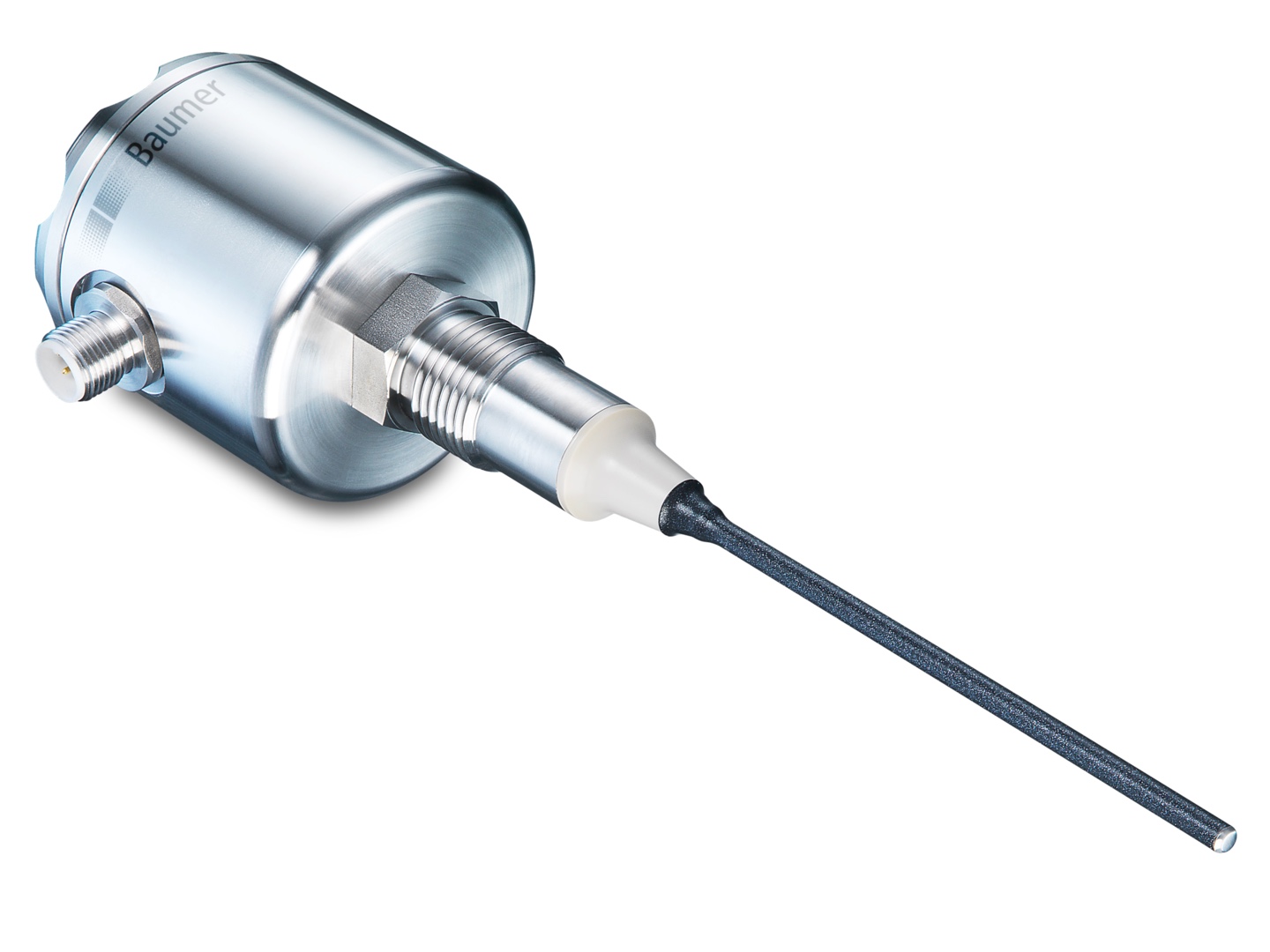

A conductive level sensor. Image courtesy of Baumer

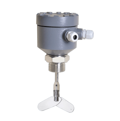

Paddle Sensors
Paddle sensors are mainly used in bulk solid container systems, or manufacturing processes using very viscous material. The basic principle involves a spinning paddle that slows or stops when the material in the bin hits the level of the tank where it is located.
Rotating Paddle Level Sensor/Switch for Solids. Image courtesy of Sapcon Instruments.
The increased torque on the electric motor in the paddle switch activates an output that is sent to the controller or operator of the system. They are reliable and often have better durability than some other types of sensors in harsh environments like the bulk cement or mining industries because of their resistance to dust and other contaminants.

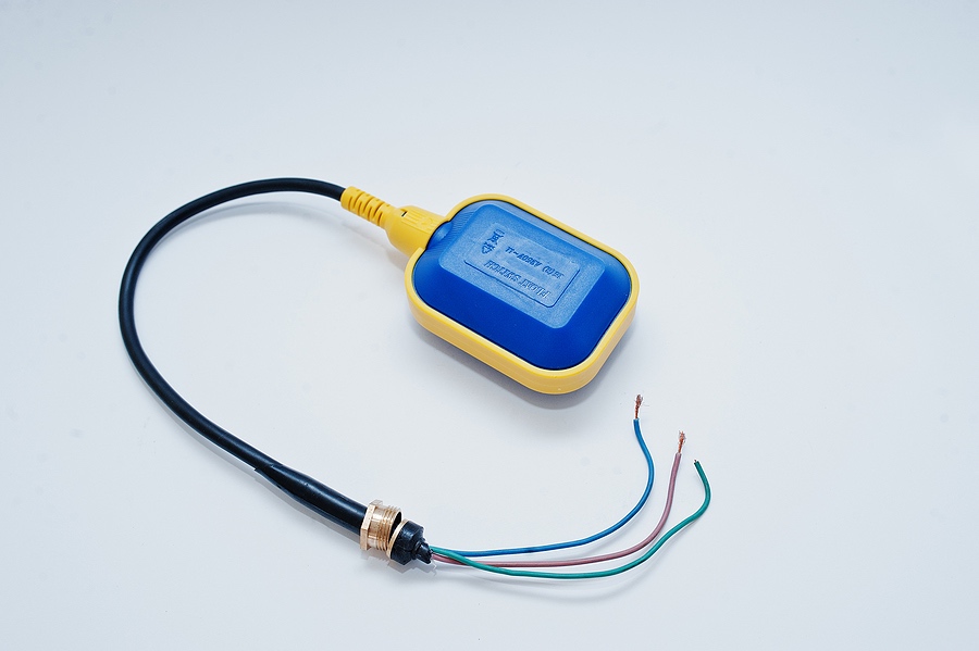

Float Sensor
Float switch sensors are some of the least complicated level sensors available. In liquid applications, they can be used in conjunction with a valve on the inlet of the tank to automatically keep the level in a tank at a certain height. They operate using the buoyancy effect of a heavier liquid lifting a lighter solid float.
Aqua float switch sensor for water level controller.
The float lifts a lever when the liquid rises in the container, which then operates a valve or an electrical switch. If it’s a switch operated float, the switch sends an output signal to the controller.

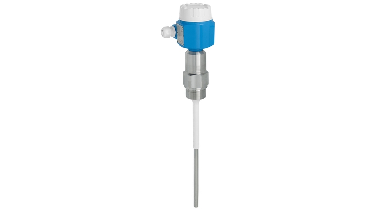

Capacitance Level Sensors
Capacitance sensors use a dielectric constant intrinsic to the type of fluid in the tank. They require a transmitter on an insulated rod or a non-insulated rod to measure the capacitance of the material in the tank. The insulated rod has a transmitter on the end of it that measures the capacitance between it and a separate receiver.
Capacitance point level detection. Image courtesy of Endress+Hauser.
As the level of the liquid in the tank goes up so does the capacitance. With a non-insulated rod, the capacitance is measured between the rod and the side of the tank. A special sensor is used to determine the capacitance in the liquid based on the feedback from the rod.
