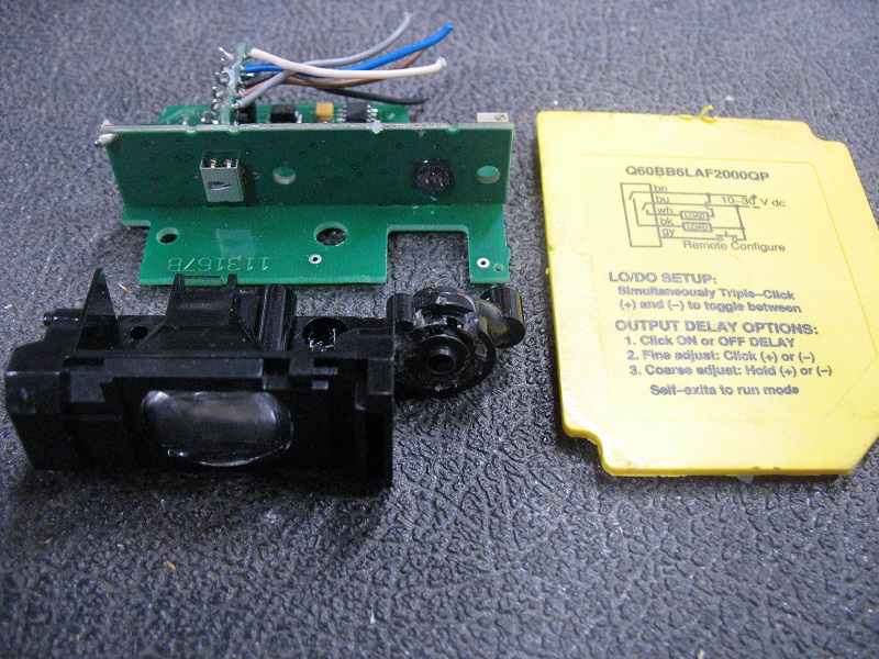

Every laser sensor has two main components:
1. An emitter
2. A receiver/transducer
Laser sensor components
Figure 1. Deconstructed laser sensor with emitter and receiver elements visible on the left and right sides of the green PCB.
The emitter sends laser pulses, and the receiver absorbs the laser pulses reflected from the object. The time difference between when the light was emitted and absorbed by the receiver is recorded. The distance traveled by the laser beam can be calculated by knowing this time, as the speed of light is a known quantity.

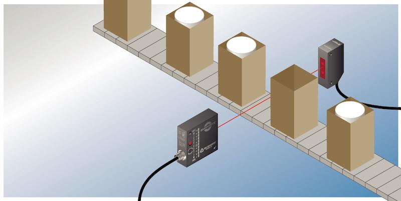

Types of Laser Sensors
Laser sensors can be used in multiple ways. Depending on the method of laser metrology, there are different types of laser sensors. The three distinct types of laser sensors are defined below.
  • Through-beam sensors: The sensor’s emitter and receiver are separate components aligned and pointed at each other. The laser beam from the emitter reaches the receiver in a straight line.
  • Retroreflective sensors: The emitter and the receiver is on the same component. The emitter is aligned and pointed at a reflector. The laser beam travels from the emitter to the reflector, bounces back, and reaches the receiver.
  • Diffused sensors: The emitter and the receiver are on the same component, but no reflector is involved. The laser beam reflects off the object to be detected and reaches the receiver.
Through beam laser sensor
Figure 2. A through-beam sensor detecting container contents. Image used courtesy of Tri-Tronics

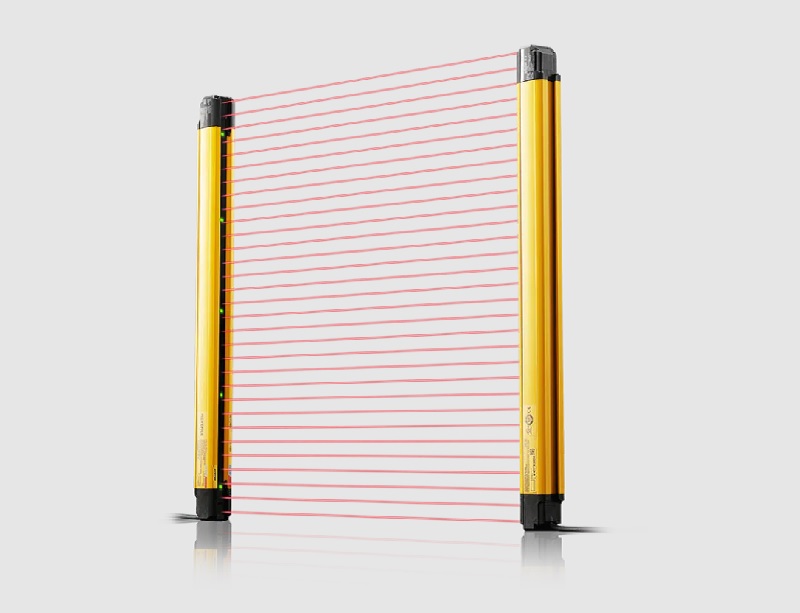

Laser Curtain
Multiple laser beams are projected to form a light barrier. One wall will have the laser emitter, and the other end will have the receivers. When an object passes the light barrier, some laser beams will be cut, and the corresponding receivers will not receive laser beams.
Light Curtain
Figure 3. A light curtain for worker safety. Image used courtesy of Keyence
This can sense objects in space and the dimensions of the foreign object. It can also be used for emergency stops and other safety measures.
