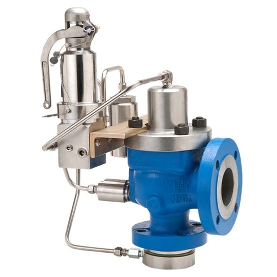

Types of Pilot Valves
Since fluids control these valves' control and, they come in two varieties, gas and liquid. In a gas pneumatic system, the air is the gas being used most of the time, so the valve will be reported as an air-operated pilot valve. When air at relatively low pressure is applied to a port in the valve, it will either open or close, allowing air to flow at a much higher flow rate.
Anderson Greenwood Series 5200 Pilot Operated Pressure Relief Valves. Image courtesy of Emerson.

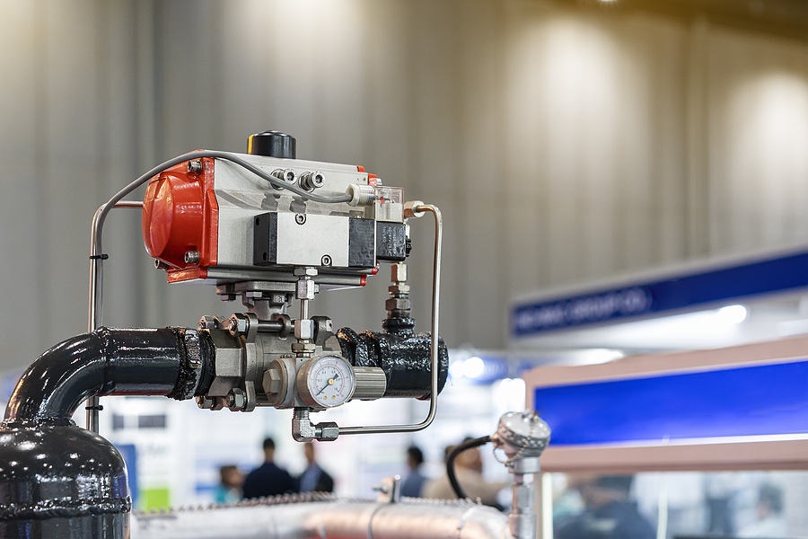

What About Electrical Pilot Control?
So far, in this article, fluid valves are controlled by separate smaller fluid flow. Technically, fluid direction and flow can also be controlled by electrical current, but they are not called 'pilot' valves. The term used for electrical valves is 'solenoid' where an electrical current loop around a core will create an electro-magnetic action, opening or closing the valve body.
Single coil solenoid and pneumatic inner thread ball valve for air pressure and direction control with pressure gauge unit of plastic injection mold machine or blow manufacturing.
These solenoid valves do accomplish the same task as a pilot valve, but they use electricity. If the control signal originates from a PLC, there is a good chance that the valve is a solenoid, not pilot operated.

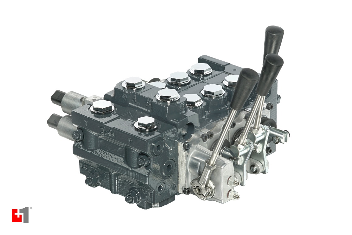

Variable Control
Variable and proportional pilot valves exist, although they are rarer than directional control (DCV) and on/off check valves. These variable valves adjust the output flow rate as the control pressure changes.
A directional control valve (DCV). Image courtesy of Danfoss.
This mimics the operation of an electrical analog valve, usually working with 0-10 volts or 4-20 mA. It is far more likely to see an analog electrical control in use than a pilot valve for variable control.
