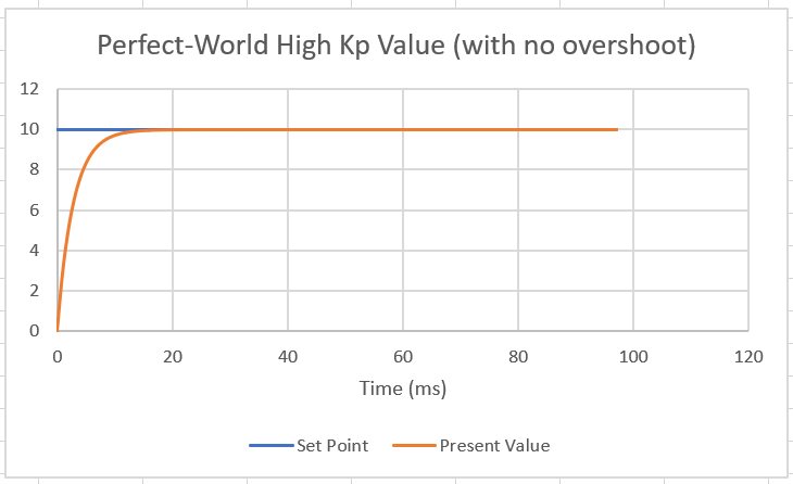

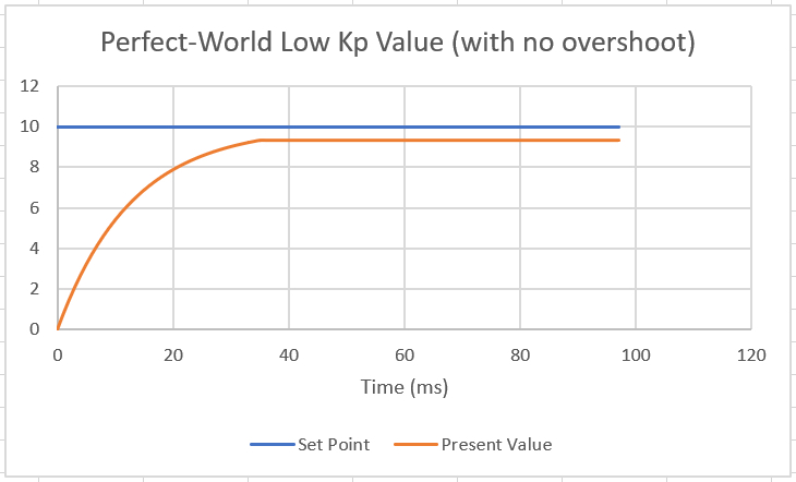

Effect of Proportional Gain
For a low value of Kp, the output signal will be smaller. This means the system will be slower to respond, perhaps seeming a bit sluggish. With a low Kp value, it will also reach a point where the output signal is so small that it can’t overcome the opposing force of the system and basically stall—never quite reaching the SP. This is called a 'steady-state error' since there is still a bit of error once the system stops responding and becomes steady.
On the positive side, a low Kp value can ensure minimal system overshoot since the output is going quite slowly by the time it reaches the SP.
Naturally, when the Kp is increased, the opposite effect is true from what is listed above.
Figure 2. A graph of a system response with only a low proportional gain value of 0.075. Note the response time is quite slow, and the system fails to reach the final SP—however, it will not overshoot the SP.
Figure 3. A graph of a system response with only a high proportional gain value of 0.3. Note the quick time to rise and settle right on the SP line. In the real world, there would be some sort of inertia leading to overshoot—this is simply a simulation of a system response.
