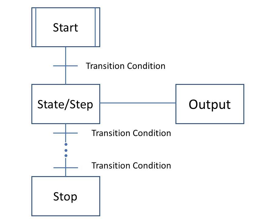

In SFC programming, states or steps are represented by rectangular boxes. A vertical straight line connects the different steps, and each step has a corresponding output. There is a transition condition between steps. Figure 1 below shows the general diagram for the sequential function chart.
Figure 1. SFC diagram that shows the separate steps that are sequentially connected.
The first box represents the start of the operation. Two states are connected with a vertical line. The horizontal lines between boxes represent transition conditions. Sometimes, transition conditions can be denoted by a much smaller rectangle between the larger states.
After a step is completed, the process moves on to the next state only if the transition condition(s) is also satisfied.
Each of the states also has corresponding outputs. Outputs are represented as rectangular boxes linked horizontally to their respective state.

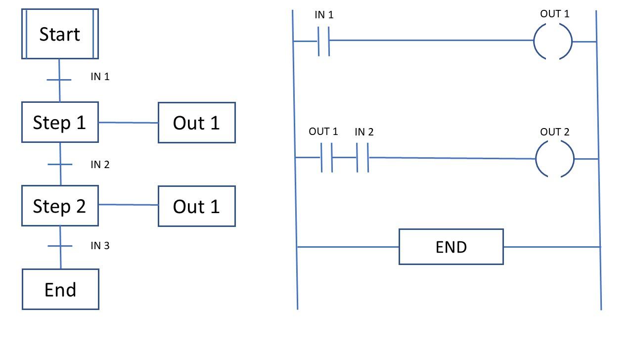

Every SFC can be represented by an equivalent ladder logic. Figure 2 shows an example.
Figure 2. SFC diagram representated by an equivalent ladder logic.
The first rung of the ladder is equivalent to Step 1. Only if IN 1 occurs will OUT 1 also activate. The second rung is equivalent to Step 2. Only if OUT 1 and IN 2 occur will OUT 2 activate.

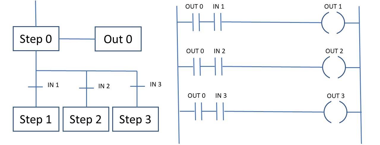

Parallel branching allows two or more states to occur simultaneously if a single transition condition is met. In diagrams, parallel branching is represented by a pair of horizontal lines.
Figure 3. Parallel branches in SFC and equivalent ladder diagram.
Once the OUT 0 is realized and the transition condition (IN 1) is met, all three steps (Step 1, Step 2, and Step 3) initiate.

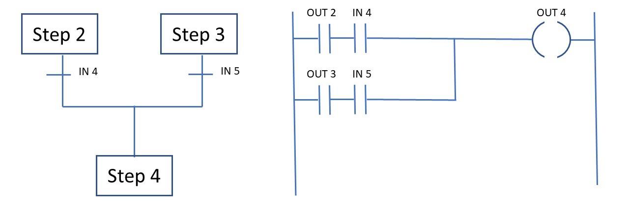

Similar to branching, there is also convergence possible in SFC programming. When two or more branches have a common subsequent step, it is convergence.
Figure 5. Convergence in SFC and equivalent ladder diagram.
Here at least one of the two combinations must be satisfied to initiate Step 4. Either OUT 2 and IN 4 must be satisfied or OUT 3 and IN5 must be satisfied to proceed to Step 4. If all the four conditions are satisfied, it will have the same effect. If OUT and IN5 are satisfied, it will not be sufficient to proceed to the next state as they are on different branches.

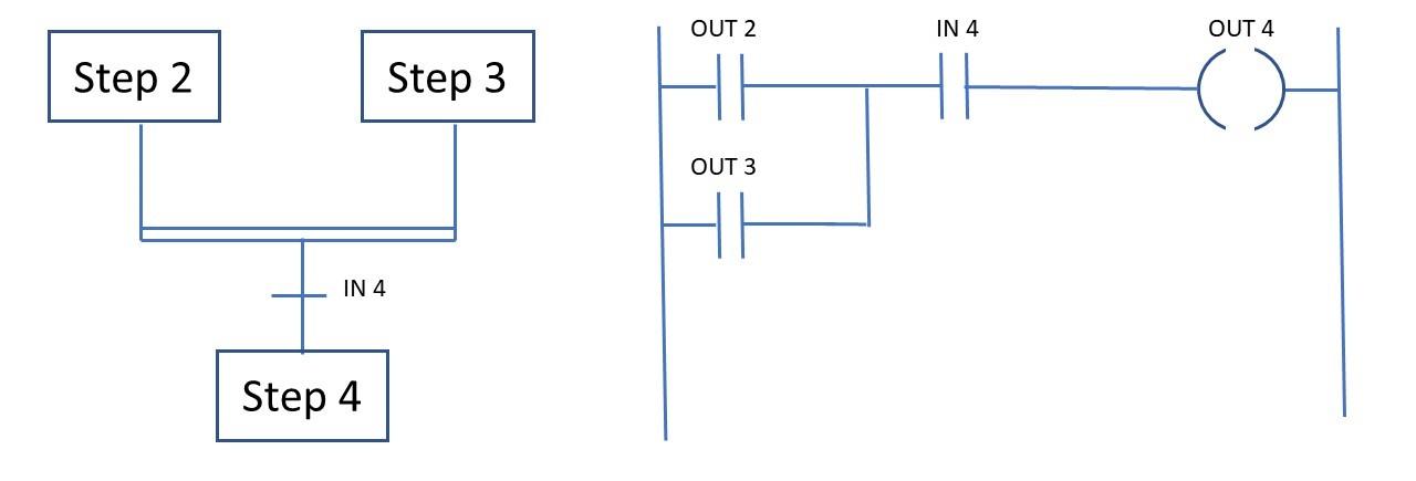

The difference in simultaneous convergence compared to general convergence is that there is only one transition condition for all the previous states converging. If either one of the outputs is realized along with the single transition condition, the process moves to the next step.
Figure 6. Simultaneous convergence in SFC and its equivalent ladder diagram.
Figure 6 shows that there is only one transition condition for Step 2 and Step 3. If either OUT 2 or OUT 3 is realized along with the transition condition IN 4, Step 4 is activated.

Fig.-2 has an error with OUT2
