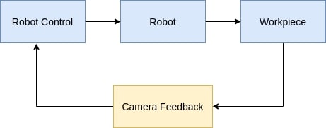

Visual servoing is the method of controlling a robot’s motion using real-time feedback from vision sensors to execute tasks. Computer vision methods extract features from the robot’s operational scene and determine how the robot should move in order to articulate the image features or converge to the task workpiece. The techniques are heavily reliant on good camera calibration, an accurate kinematic model of the robot, good IK and FK solvers, and satisfactory camera performance (good pixel resolution, FPS, shutter speed, etc.).
Visual servoing is analogous to a PID controller, a model-free approach to actuate the robot based on the reference high-level task to be executed. The image information is transformed into useful task progress metrics. The robot is instructed to move in order to align its current task progress metrics with the desired task metrics and gradually reduce the error between the two.
Visual servoing process flow
Figure 1. Visual servoing process flow

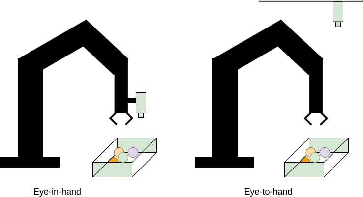

A real-world 3D object/scene is projected onto a 2D image in monocular cameras while depth cameras include the third dimension as well and help execute more sophisticated tasks. Depending on the positioning of the camera, visual servoing has two paradigms: eye-in-hand and eye-to-hand (see Figure 2).
Camera-mounting-based visual servoing paradigms
Figure 2. Camera-mounting-based visual servoing paradigms
The camera is mounted on the end-effector of the robot in the eye-in-hand configuration while it is mounted on a fixed location in the world. Thus all camera observations made in the eye-in-hand paradigm are with respect to the camera which has a known transformation with respect to the end-effector of the robot ( which is in motion). Meanwhile, the eye-to-hand paradigm has fixed a camera frame with known transformation from the robot base or another origin.

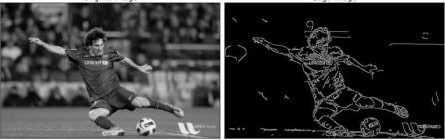

Several image processing and computer vision methods are applied to extract meaningful information from a scene or consecutive images (using optical flow) and conform them to servoing scheme dimensions. These features could either be high-level scene information like object detection, object recognition, and semantic segmentation or minute pixel-level information like edges, lines, facial features, corners, color blobs, and ridges.
Canny Edge Detector available in OpenCV.
Figure 3. Canny Edge Detector available in OpenCV. Image courtesy of OpenCV.
Feature extraction tools like Canny detector, FAST corner detector, Shi-Thomas corner detector, and algorithms like SIFT, SURF, BRIEF, and ORB have been used in classical image processing applications. New deep learning techniques have also been deployed lately for enhanced image interpretation and more dynamic object-level (object pose, orientation, dimensions, type, etc.) information extraction.

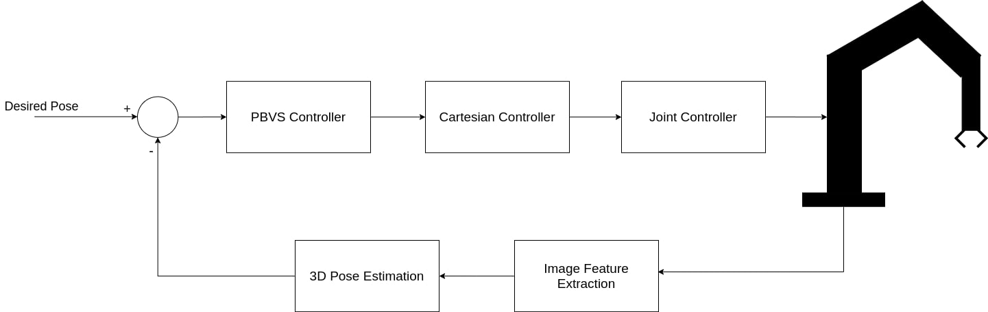

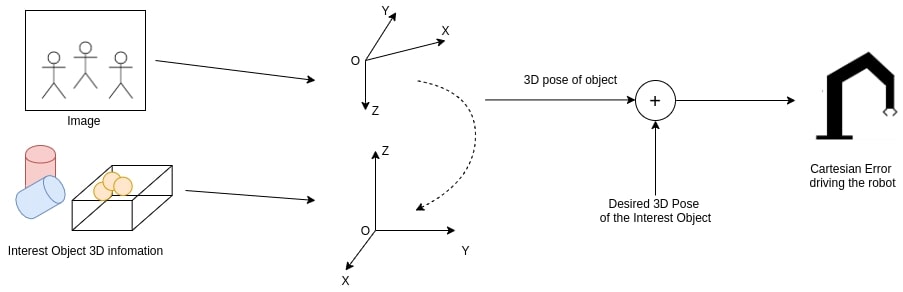

Position/Pose-based Visual Servoing
PBVS usually uses depth cameras to obtain the 3D pose — position (x, y, z) and orientation (Euler or Quaternion) — of the regions/objects of interest and compares the robot’s end-effector’s pose against it. The error term e thus formulated is the Cartesian pose difference between the two and the servoing scheme attempts to minimize it by moving the robot around, ideally towards the final desired pose. For example, based on the location of the object to be grasped seen in the image, the scheme generates the ideal grasp pose (which may keep changing due to relative change in camera pose) for the end-effector and tries to converge the robot to it.
PBVS workflow
Figure 4. PBVS workflow
Since PBVS works with real-world poses, it needs at least a 6-DOF robot arm to successfully implement the solution without getting stuck in local minima. It also uses robot inverse kinematics to convert Cartesian control instructions into joint angle values for the robot. Since obtaining the 3D pose involves the conversion of information from the camera frame to the robot frame, camera calibration plays a significant role in the process.

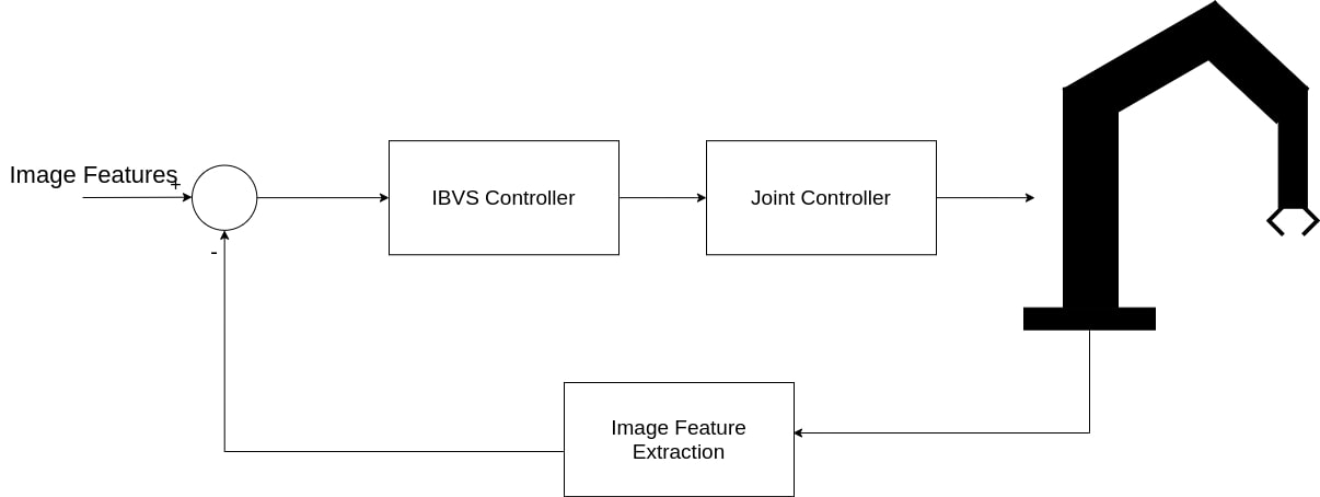

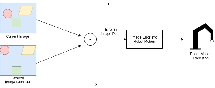

Image-Based Visual Servoing
Unlike PBVS operating in the real-world 3D pose, IBVS extracts camera features and then formulates the error in the image plane itself. On an intuitive level, if the position coordinates of the desired feature in an image are [0.2, 0.5] and the current position coordinates of the image are [0.5, 0.5], the visual servoing scheme tries to converge the feature to the desired coordinates and moves the robot accordingly.
IBVS workflow
Figure 6. IBVS workflow
The first step of IBVS is the projection of the 3D image on a 2D image plane. The image feature extraction in IBVS is prone to poor camera performance, synchronization issues, and computational requirements. Owing to the mathematics, to define the control logic for a 6-DOF robot arm, at least three features are needed in the image. The feature Jacobian (which encodes the information about the motion of image pixels) is responsible to derive the control signal for the robot by relating the motion in feature pixels against the same for the end-effector.
