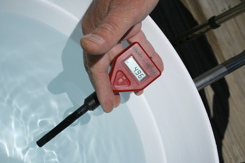

Handheld pH meter
Figure 1. The pH of a solution is checked with a portable meter. Image used courtesy of Ildar Sagdejev on Wikimedia Commons

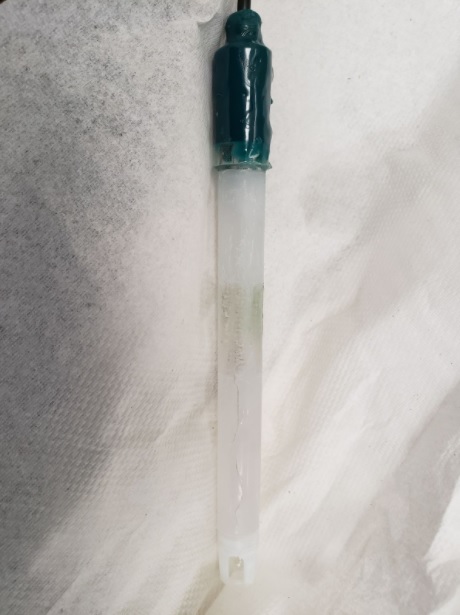

Melted meter
Figure 2. The pH probes are sensitive to chemical attack. This probe was left in ethyl acetate for three hours during a routine undergraduate experiment. Notice the “melted” effect of the plastic. Students were clued in to the problem when the pH meter began to read a pH of 57, which is nonsensical. Author’s photo.

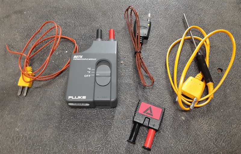

To account for this effect, some pH sensors have a built-in temperature sensor. This is typically either a Pt-100 RTD, a thermistor, or a K-type thermocouple located near the probe tip or in the meter itself. The latter assumes that the temperature difference between the meter and the probe is small.
Various thermocouple options
Figure 3. K-type thermocouples and adapters may be used for temperature-based calibrations.
If there is no built-in temperature sensor, the instrumentation engineer must account for the effect of temperature on the pH measurement. This can be performed mathematically, or perhaps more commonly, by calibrating the pH probe at temperature.
