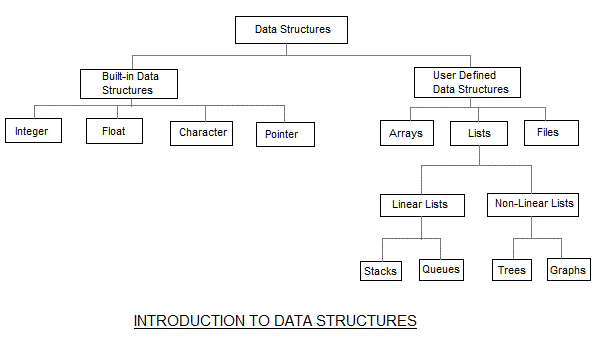

A diagram of types of data structures. Image courtesy of Sri Venkateswara College of Engineering.
One of the more confusing data types is the 'Structure' type tag. It can be incredibly confusing because you can define what it is and when you should use it with every other data type. With structure type tags, they can look entirely different between uses, and those uses can be widely varied.
