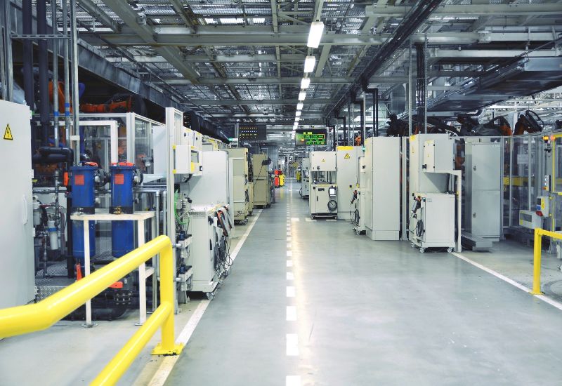

mechanically generated heat and environmental temperatures affect machinery
Figure 2. Not only is overheating of equipment caused by environmental temperature, but it is also brought on by machines themselves. Image used courtesy of Canva
Mechanically Generated Heat

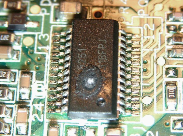

Controllers and other fine electronics, such as laser sensors, industrial computers, and network components, are among the devices more sensitive to high temperatures. Of course, most of these devices exist in their durable, rugged version. However, we are talking about most of the installed base of components with standard operating temperature ranges. By the way, the typical operating range of these devices is between 0 °C and 60 °C.
Now, at first thought, 60 °C seems high enough that it should cover all operation scenarios. In reality, this upper limit is not too far from the temperature that can be reached within certain areas or steps of an automated process.
The environmental temperature, naturally, plays a crucial role here, but it is not the only factor. There is also the heat generated by large machinery and the internal heat generated by motors, conveyors, controllers, and electronics. All of these add up, leading to parts of the system where the temperature could easily exceed the operating range of some devices.
A PCB component with heat damage
Figure 3. A PCB component that suffered heat damage. Image used courtesy of Petteri Aimonen

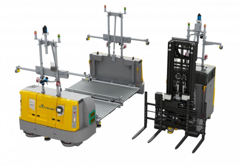

Laser Guided Vehicles (LGVs) are battery-run automation equipment
Figure 4. Laser Guided Vehicles (LGVs) are just one example of battery-run automation equipment vulnerable to heat-related issues. Image used courtesy of Electtric80
Forklifts are perhaps the most well-known battery-operated industrial machine, but there are also automated systems that run on batteries. Among these, LGVs are the most recognizable, with a growing presence in industrial automation.
LGVs can experience heat-related issues similar to those of EVs. Lithium batteries even power many modern LGV systems. However, when LGVs operate under very high environmental temperatures, their batteries are consumed faster, leading to a higher frequency of battery charges or changes. Also, since LGVs are industrial automation machines, they can experience the same issues discussed previously. Their controller, motor drives, and sensors can exhibit the same symptoms of heat damage as those components running other more traditional automated systems.
