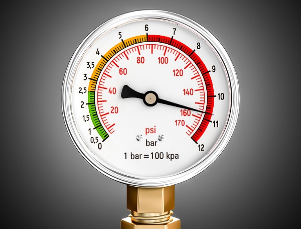

Pressure gauge with psi, bar, and kpa
Figure 1. Pressure can be defined by many units, but always a force distributed over an area. Image used courtesy of Adobe Stock

In the US, the most common pressure unit is psi (pounds per square inch). One PSI equals 6,894.75 pascals. Actually, you should say, “One pound of force per square inch.”

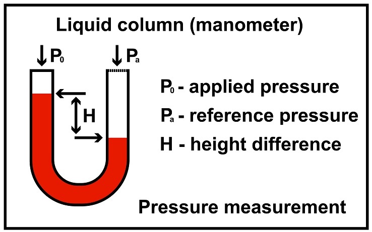

Inches of water (InH2O): When subjected to pressure, a column of water will rise in a sealed tube. One inch of water column is equal to approximately 0.036 psi. This tiny value is quite useful because even pressures well below 1 psi will produce a large water column, accurately measurable with a sight gauge.
Manometer for measuring liquid column
Figure 2. Liquid columns can measure pressure differences. If the top of Pa (reference) is sealed in a vacuum, the measurement P0 will be absolute pressure. If the top of Pa is open to the atmosphere, P0 will show gauge pressure. Image (simplified) used courtesy of Adobe Stock

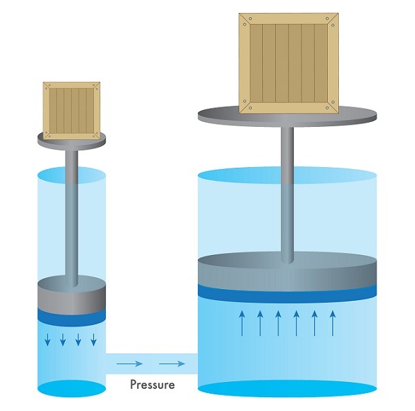

Pascal’s principle states that any pressure changes applied to the surface of an enclosed fluid are transmitted evenly throughout the fluid. As long as a valve is open, the pressure at all points is equal, save for the small pressure drops across components with frictional losses. This makes fluid system distribution very easy.
Equal pressure, but with different forces and surface areas
Figure 3. Two points in the same system, equal in height if both ends are open to air, will have equal pressure. Image used courtesy of Adobe Stock
