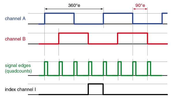

Encoder output waveforms
Programmable encoders allow adjustment of basic parameters such as pulse train and reference/index signal. Image used courtesy of maxon
Some of the parameters that can be programmed include
  • Pulse number: The number of pulses in a complete revolution, which also indicates the resolution of an encoder
  • Output type: TTL or HTL (transistor-transistor, or high transistor logic styles). These are the common output types, indicating the voltage levels of high and low signals.
  • Pulse sequence or direction – Counter ClockWise (CCW) and ClockWise (CW): The sequence of pulses by encoders are typically determined by two trains of pulses 90° apart from each other.
  • Reference Signal: A signal indicating the passage of a specific number of pulses or positions. Typical values include 90° or 180°

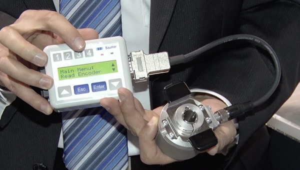

Programming Device
The programming device comprises a battery-operated, handheld device connected to the encoder through a communication interface. The programming device can also be used to store the programming parameters of encoders, easing the effort of commissioning multiple encoders in similar equipment.
Programmable encoder demonstration
A handheld programming device directly connects to the encoder through a communication cable for configuration. Image used courtesy of Baumer

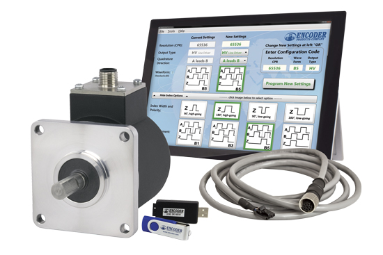

Storage of Configuration Data
As mentioned previously, storing configuration data electronically for later use, such as copying and uploading to another programmable encoder, is possible. This helps engineers store and recall process parameters for future reference, such as replacing and upgrading.
Example programming an encoder
It is possible to store configuration data in a programmable encoder electronically for later use. Image used courtesy of Encoder Products
For conventional encoders, it often becomes difficult to remember the specifications. Documentation is often less than perfect, and labels can fade or tear away. Creating hard copies of the encoder specification may also prove difficult because manual records can be lost or misplaced.
