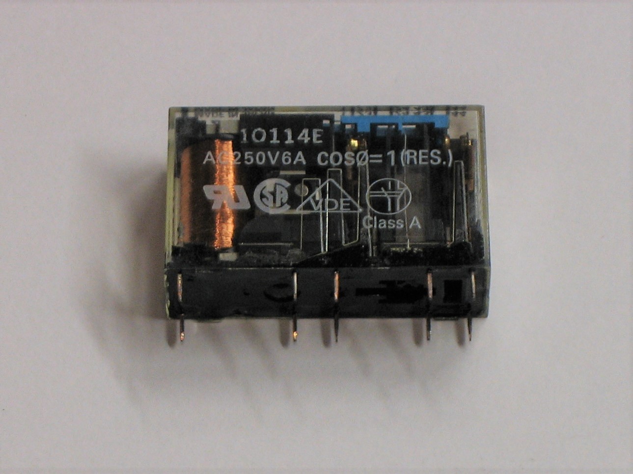

mechanical relay
This mechanical relay shows 4 contact sets displayed by the visible copper tabs. Each contact set has an NO and NC contact. This relay is ideal for logic control circuits.
