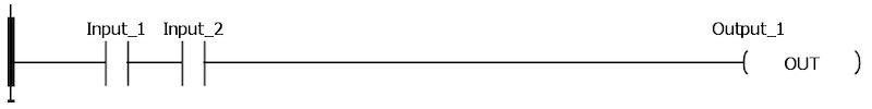

Consider the following example ladder diagram in figure 1.
ladder logic
Figure 1. An example ladder diagram showing two inputs in a series leading to the output.
In this diagram, two inputs are placed in series leading to the output. Since ladder logic, as indicated by name, is logical, we should be able to express the statement in plain English. “Input_1 and Input_2 must both be TRUE in order for Output_1 to become TRUE”. In this statement, the use of the term AND indicates the logical instruction.
To turn the comparison to a setting a computer programmer would better recognize, the C++ code would be as shown in figure 2.
bool Input_1 = 0;
bool Input_2 = 0;
bool Output_1 = 0;
void loop () {
     if (Input_1 == true && Input_2 == true) {
          Output_1 = true;
     else {
          Output_1 = false;
Figure 2. Same logic as figure 1 but shown in C++ programming language.
Both of these code examples follow the rules of boolean AND logic.

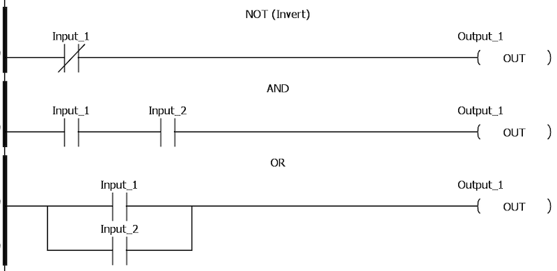

There are seven primary boolean logic structures. AND is one of the simplest.
Boolean Logic Structures: Inverter, AND, OR
The first three are the Inverter, AND, as well as OR. The inverter simply causes a True input condition to create a False output condition; and, therefore, is the only logical structure with only one input.
ladder diagram boolean logic
Figure 3. Ladder diagram showing an inverter boolean logic structure.

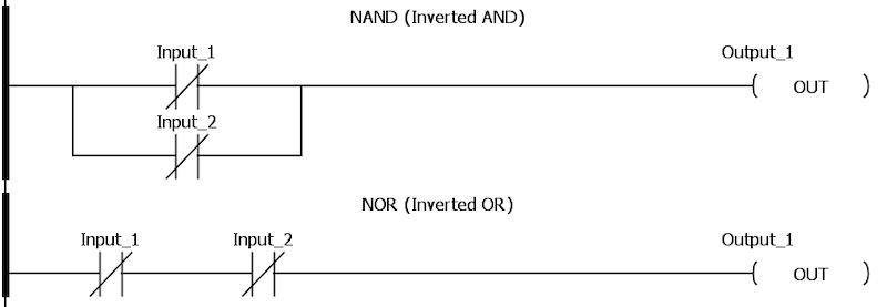

Boolean Logic Structures: NAND, NOR
The next two logical combinations are NAND as well as NOR. To best consider their effect in ladder logic, think of the AND/OR logic, respectively; the result is the exact opposite. Whatever combination made the original logic True is now the exact combination making the output false.
Regarding the NAND: “Output_1 will be True if either Input_1 or Input_2 are False”.
As an example, two liquid tanks must be full, each monitored by a sensor. If either sensor goals false, an alarm must sound. Now, this could be accomplished with N.C. real-world sensors, like an E-stop circuit, but it can also easily be accomplished with existing N.O. sensors using the NAND logic.
The NOR is more typical for an emergency stop (e-stop) situation (as shown in figure 4). “Both Input_1 and Input_2 must be false for Output_1 to remain True.”
NAND vs NOR logic
Figure 4. NAND versus NOR logic in a ladder diagram.

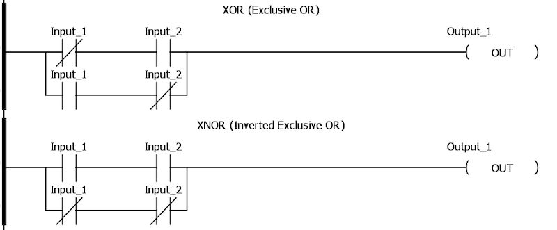

Finally, there are two combinations used more rarely in PLC logic, yet still exist in boolean logic.
Boolean Logic Structures: XOR, XNOR
Exclusive OR (XOR) means the output will only be True if Input_1 is True and Output_2 is False, or the reverse. It’s sort of like OR, except that OR also works if both are True.
Exclusive Inverted OR (XNOR) is True only if both inputs are False, or if both inputs are True. Again, it’s the opposite of XOR.
ladder logic NOR XNOR
Figure 5. Ladder diagram example of XOR and XNOR logic.
