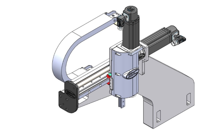

Pick-and-place (PnP) stations are quite common with industrial automation equipment. Typically we use a PnP station to move parts from a conveyor or storage location to a fixture where the part can be worked on. A PnP station is more cost-effective than a robot but is more rigid with the motions it can perform.
Servo pick-and-place
Figure 2. Using a servo in a pick-and-place station. Image used courtesy of Steven Douglas Corp

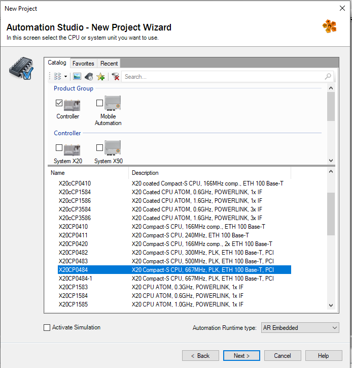

When creating a new Automation Studio (AS) project, AS will require the controller you would like to use within your project. Once the controller is selected, the project will be created and you can start adding other components to your project from the toolbox. Be careful with the length of your project file name, if the name is too long, AS will have errors and not be able to compile.

The size of our project is quite small with only a few retentive variables, so I’m going to use the Compact-S model. The X20CP0484 operates on a Cortex A9 processor with 2 GB of onboard flash memory. If more computing power is required, you can also move up to a panel PC or the box PC which will run the Automation Studio Runtime. When creating a new project in Automation Studio, you will be prompted to select your controller and backplane.

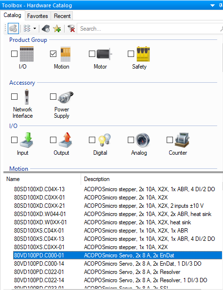

A typical PnP station will have two servos, one for the Y-axis and one for the Z-axis—the X-axis will be the conveyor. In the toolbox, select the motion icon and then select the servo drive you would like to add to your project.

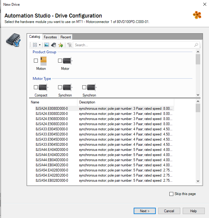

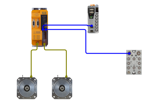

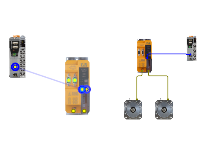

Drag that item into the hardware designer window. You can now connect your controller to your drive by simply clicking and dragging a line from the controller port to the drive port. Once this connection is made, AS will prompt you to add your selected servo motor. A second prompt will appear if the selected drive is capable of supporting two motors.
Lastly, you will need to select which motion system will be used to control your servo motors—in our case we will use mapp Motion.
adding motion controller in toolbox
Figure 4. Adding motion controller in toolbox.

Our gripper will consist of a pneumatic gripper, requiring one output for opening and one for close. We will use reed switches on the gripper to detect the individual states; the switches will be connected to remote input modules. The outputs will be pneumatic valves which will drive from a remote output module.

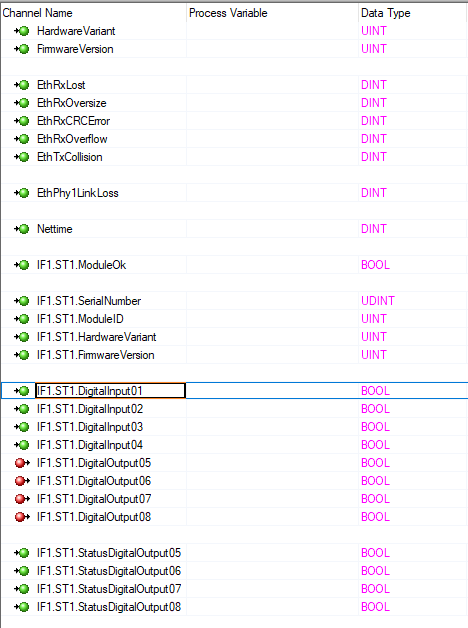

The X67 remote input and output module will be used as our field-ready module that has configurable input and output ports. The X67 uses the PowerLink industrial Ethernet protocol and can be selected from the toolbox by searching x67 and then selecting the X67BC8331. Drag the IO module into the project area and connect the PowerLink port to the drive. Right-click on the module to configure the output channels—we are going to set four channels to outputs. Right-click on the module again and choose the IO mapping option. Variables can now be mapped to physical inputs and outputs.
All components added.
Figure 7. All components added.
IO mapping.
Figure 8. IO mapping.

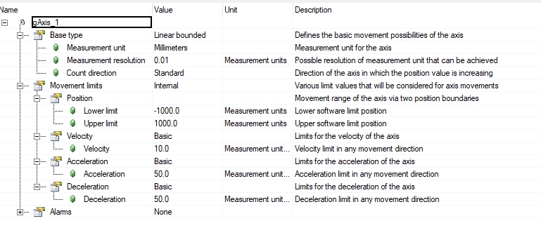

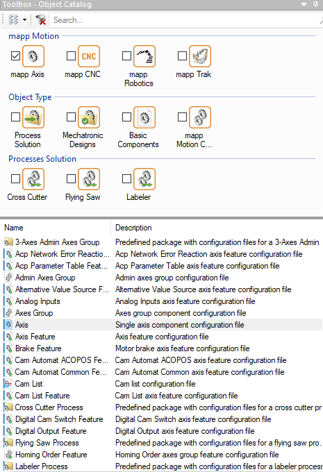

Similar to many other PLC servo drive systems, there are many parameters that can be set for the servo motors. Highlighting the mapp Motion folder and clicking on the mapp axis icon in the mapp Motion heading will reveal the configuration files that can be added to your system.
We are going to add the axis file by double-clicking on the single-axis component configuration file. Repeat this process for the second axis. When you open up the configuration file you will see parameters that can be set.

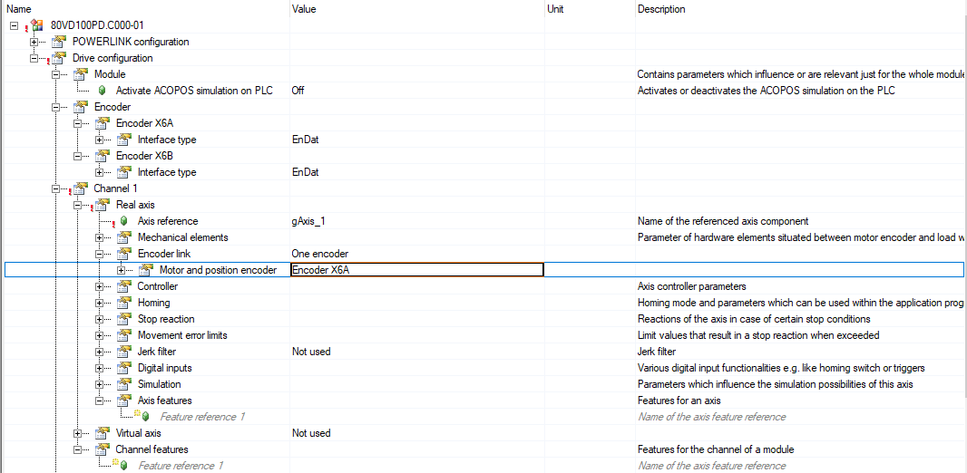

Now that we have our axis configuration files added, we need to tell the drive which configuration files to use with each axis. In the physical view, right click on the servo drive and select configure. Each channel is an axis with a configuration file pointing to the axis reference parameter. There are additional parameters that can be set here as well.

Servo drive configuration.
Figure 11 Servo drive configuration.
