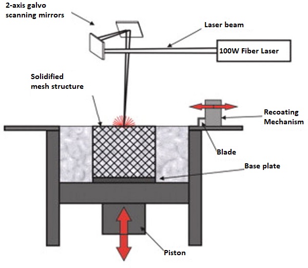

Selective Laser Melting or Selective Laser Sintering
Selective Laser Melting (SLM) or Selective Laser Sintering (SLS) is probably the most common technique used in metal AM. Typically, this is performed using a bed of metal powder and a high-intensity laser. The laser can precisely focus heating into one small area, melting the material quickly in that spot. The laser does not remain energized in place long enough to allow the heat to diffuse and melt surrounding particles. The success of this design relies on the resolution (focus point) of the laser and the power and relates directly to how quickly it can heat.
With the heat from the high-intensity laser, the design’s pattern is traced across a bed of metallic powder, selectively melting only the material it hits, while leaving the rest unheated and unmelted. Depending on the configuration, more powder is added to the top surface and the bed lowered to produce the next layer. Multiple layers are built up one at a time, rastering the laser across the surface over and over again. The finished part is removed, with a light dusting from pressurized air to remove any remaining metal powder.
Schematic for SLM
Figure 2. SLM/SLS diagram illustrating laser path onto the object (mesh structure). Image (modified) used courtesy of Wikipedia Commons

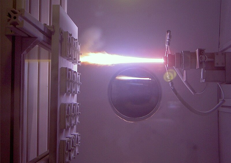

Thermal Spray
Thermal spray is a set of technologies where a metal powder or wire is fed into a spray nozzle and propelled toward a surface. The metal powder or wire feedstock is melted using one of a variety of techniques, and the droplets are blasted onto the substrate. In practice, each individual droplet does not have the thermal energy to damage the substrate. Droplets freeze on contact, forming a mechanical bond. The more times the nozzle passes over the surface, the thicker the coating becomes.
Vacuum plasma additive
Figure 3. Vacuum plasma spraying is one thermal spray technique. Image used courtesy of Wikipedia Commons
Originally designed for coatings, most of these thermal spray techniques can be applied to make free-standing objects. In this case, the torch or nozzle is passed over the substrate many times to build up a thick coating. Then, the substrate is removed, leaving behind the coating. The substrate can be sprayed with a non-stick mold-release agent, like boron nitride, or can be made of a material that can be dissolved away, depending on the coating chemistry. Aluminum substrates can be removed with a caustic solution, as an example.
Spraying can be performed on flat coupons to build up flat structures, and it can also be performed on a rotating mandrel to make round objects.
