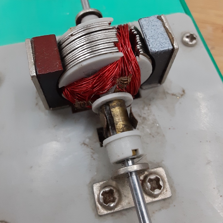

To counter this problem, traditional DC motors use a pair of soft carbon brushes that provide contact from the incoming wires to the opposite sides of the rotating rotor in the middle. The brushes are naturally the reason these are called ‘brushed’ DC motors, although they may not always include the term. If you purchase a regular ‘DC Motor’, you could probably assume it is operated with internal brushes.
This cutaway sample motor shows the ‘brushes’ as the brass tabs on both sides of the shaft. The metal contacts on the shaft are separated to cleanly switch from the static DC + and - on the outside to reverse the polarity of the armature windings on the rotor.
The rotor on the inside of the motor has a set of separated metal plates, at least two of them, attached to the shaft. The brushes from the external wires will physically contact two of the plates, energizing them and therefore magnetizing the coils in the center (the armature). Just as the rotating magnet is about to line up with the external fixed magnetic field, the brushes will slide onto the next set of plates, changing the coil polarity at just the right moment.
The nice thing about this system is that the field will change polarity at the right moment no matter the motor RPM, since the plates on the shaft rotate along with the rotor, making it a self-adjusting system.
A major downside to this brushed system is the friction and dust generated by the wearing of the brushes. Physical contact always leads to friction and waste heat loss. It will also lead to maintenance factors and regular replacement of the spring-loaded brushes.
Additionally, those coils being energized, then the brushes moving to the next set of plates creates a reverse voltage, often called ‘flyback.’ This generates a spark that would be clearly visible if you could see inside the motor where the brushes touch the shaft.

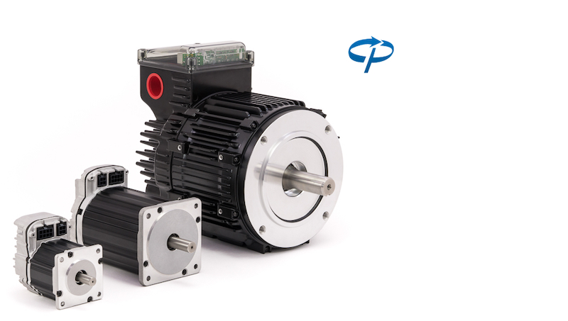

As the name indicates, there are other strategies for alternating the polarity aside from the noisy, inefficient carbon brushes. Brushless motors rely on transistor circuitry to reverse the direction of the current to the windings regularly, depending on the speed of the motor.
Removing the physical contact improves the efficiency, but it adds difficulty in control since the alternation of the magnetic fields must be kept in time with the RPM of the motor.
Brushless DC motors. Image courtesy of Teknic.
True brushless motors use a device called an ‘electronics speed control’ or ESC to convert signals from a processor (usually pulse-width modulated signals) into a circuit providing alternation by precisely switching certain silicon-controlled rectifiers. These brushless motors can reach high speeds with very high efficiency and are often seen under the blades of drones and other UAVs.
If provided with the proper gear reduction to convert speed to torque, the torque output can be very high. A common modern application for brushless motors is the drive unit for cordless drills from nearly all tool brands.

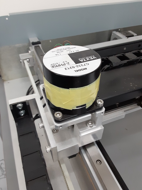

Another type of motor that technically fits in the brushless category is the stepper motor - although these will never be called ‘brushless motors’. The internal circuitry does control the polarity of current through the coils in a similar manner.
This stepper motor does not contain brushes but is almost never referred to as a true brushless motor. It is meant for deliberate, precise step-based motion.
However, the motor is driven by individual distinct step pulses from a driver circuit, making it a slower, yet far more predictable motor. Expect to see stepper motors on nearly every small CNC machine and 3D printer.
