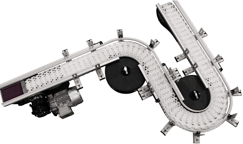

Figure 1. A fast bucket conveyor. Image used courtesy of Bosch Rexroth [PDF]

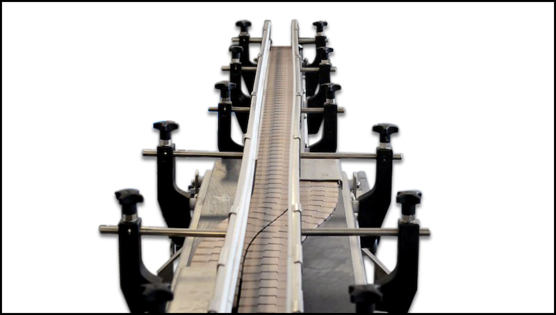

Continuous Motion Conveyor
This style of conveyor is typically found on bottling lines or food production. One can find continuous motion production in any factory where the product manufacturing cannot stop without repercussions. The product is transferred to and from process machines without stopping. This conveyor style is typically very fast and limited only by the speed of the machines that do the processing.
Figure 2. A bottling conveyor. Image used courtesy of Tri-Mach

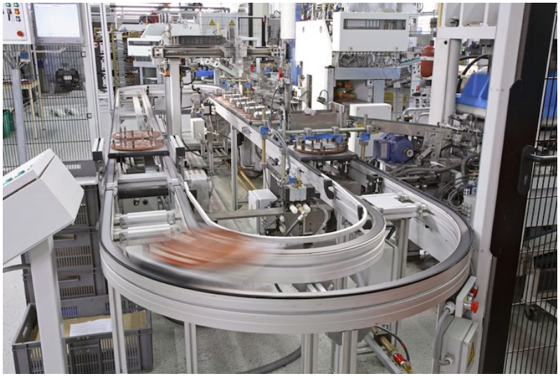

Figure 4. A low-friction conveyor. Image used courtesy of Dorner
Motor speed: A typical AC motor RPM is around 1750–3500, too fast for a conveyor. A gearbox or gear reduction device is required to reduce the total motor RPM. If the system cycle time and size of the drive roller are known, then we can easily calculate the RPM required.
Product weight: As the product’s weight on the conveyor increases, the force required to move the product also increases. Product weight can also affect belt acceleration and deceleration. A low friction belt conveyor, which relies on shuttles or products to slip on the belt when stopped at a station, will have a maximum payload. This style may have to be switched out to a chain conveyor or heavy-duty roller conveyor. A servo track conveyor will be susceptible to payload due to the shuttles being held on with magnetic force.
