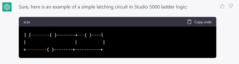

May you write me a simple latching circuit in Studio 5000 ladder logic?
Sure, here's a simple latching circuit in Studio 5000 ladder logic:
Explanation:
This circuit uses a single input (I:1/0) and a single output (O:1/0). When the input is turned on, the output will latch on and stay on until it is manually turned off.
The circuit is made up of two rungs. The first rung is a normally open contact (NO) connected to the input. When the input is turned on, this contact will close, allowing power to flow to the second rung.
The second rung is a latch. It consists of a normally closed contact (NC) connected to the output, a set (S) coil, and a reset (R) coil. When power flows through the first rung, the S coil will energize, causing the NC contact to open and the output to turn on. The R coil will remain de-energized, keeping the latch in its current state.
To turn off the output, you can use a normally open contact connected to the reset coil. When this contact is closed, the R coil will energize, causing the output to turn off and the latch to reset.
The explanation is very detailed, but some of the logic describing the latch is vague and would not provide the right information to program the PLC. For example, the explanation text states that in the second rung, an NC contact is connected to the output, a Set, and a Reset. If both the S and R are attached to the same input contact on the same rung, the rung is not properly designed.
Even though the ladder logic diagram output by ChatGPT is creative in using pipes for contacts and parenthesis for outputs in its attempt to build the circuit image, it is not particularly helpful. Additionally, even though the prompt asked for a code according to Studio 5000, the addressing structure (I:1/0 and O:1/0) was provided in a manner like RSLogix 500 for older PLCs.

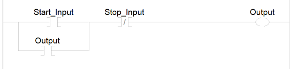

Again, not particularly helpful but creative. A correct form of a latching circuit in ladder logic should resemble something similar to the below image:
Ladder logic structure for a latch circuit, latching circuit, latched circuit
Figure 3. Ladder logic structure for a latching circuit.

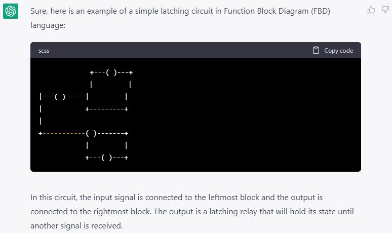

The second diagram-based language to test is the function block diagram language or FBD. Passing in the request to the ChatGPT API:
May you write me a simple latching circuit in Function Block Diagram language?
Sure, here is an example of a latching circuit in Function Block Diagram language:
![Latching Circuit FBD](https://i.imgur.com/1zV7xKX.png)
In this circuit, a push button (PB) is used to toggle the output (Q) between high and low states. When the PB is pressed, the SR latch (SR) is set, causing Q to go high. When the PB is released, the latch remains in its current state, so Q stays high. To reset the latch and return Q to a low state, a separate reset input (R) can be used. When R is activated, the latch is reset, causing Q to go low.
Using the ChatGPT API above yielded a URL link to a .png image file. Upon the first review of the output, I was hopeful and excited that the AI tool had generated a true image of an FBD for a latching circuit. However, the link resulted in an error upon redirection in a web browser. Therefore, I again turned to the web UI to see if a different result could be obtained:
ChatGPT output upon request for a function block diagram of a latching circuit
Figure 4. ChatGPT output upon request for a function block diagram of a latching circuit. Image provided by the author, courtesy of OpenAI
Similar to the ladder logic request, ChatGPT struggled to output a useful diagram but provided helpful text-based information in its response.

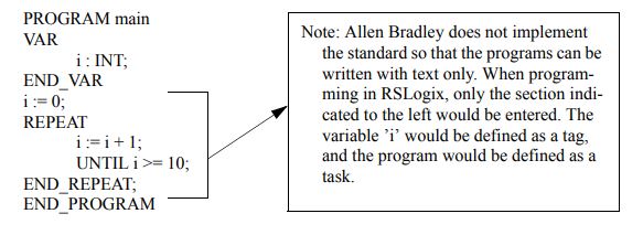

Overall, the result provides a robust framework for building a structured text program. There would likely need to be some changes to the above code in order to have it function with Studio 5000, notably the declaration of tags. An example of such a declaration is below:
Variance in structured text for RSLogix PLCs.
Figure 5. Variance in structured text for RSLogix PLCs. Image used courtesy of infoplc
