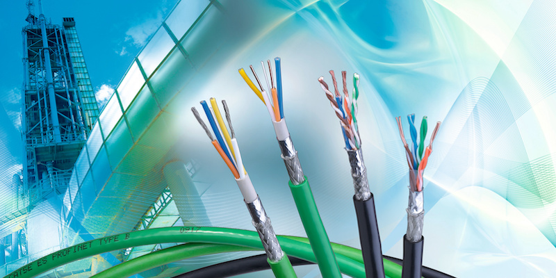

Ethernet cables
Figure 1. Communication cables rely on strict standards of colors, pinouts, and shielding capabilities for industrial environments. Image used courtesy of Belden
The RJ45 connector is built in accordance with the Universal Service Ordering Code (USOC) system, defined and implemented by Bell Systems. The specifications define signal semantics, wiring, and physical construction of the connector. RJ45 is an 8-position, 8-contact (8P8C), twisted pair, modular connector.

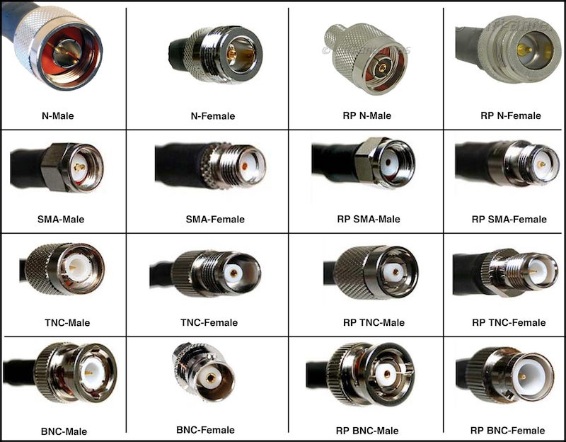

Coax terminals
Figure 3. A wide variety of coaxial cables end connectors. Image used courtesy of Arcadian
Coax Cable Types
Coaxial cables vary in gauge and impedance. The most common two impedance values of coaxial cables are 50 Ω (ohm) and 75 Ω. The gauge of coaxial cable refers to the thickness of the cable. The thickness is measured by RG number (radio guide). The lower the RG number, the thicker the central conductor of the coaxial cable. The most common sizes of coaxial cables available are RG-6, RG-11, RG-58, RG-59, and RG-62.
