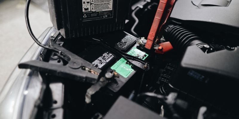

There are literally hundreds of videos on YouTube where someone shorts a car battery with a wrench. The results are similar, with dramatic sprays of sparks, sometimes fire, sometimes the red-hot welding of the wrench to the battery posts or melting the terminals. From Ohm’s Law, it’s easy to see why this happens:
$$I = \frac{V}{R}$$
Car battery
Figure 1. Batteries are a common source of energy, but voltage alone does not define the power output capability. Image used courtesy of Canva
A lead-acid car battery is 12 V, and a good steel wrench has very little resistance (assume 0.06 Ohms, for ease of calculation).
$$I = \frac{12~V}{0.0~\Omega}$$
$$I = 200~A$$
In terms of power (heat) generated:
$$P = I^{2} \times R$$
$$P = (200~A)^{2} \times 0.06~\Omega$$
$$P = 2400~W$$
Revisit these calculations with a 9V battery. Plenty of kids learn they can lick the top of a 9 V battery and determine if it still has a charge. A tongue has very low resistance as well (assume 0.03 Ohms, for ease of calculation).
$$I = \frac{9~V}{0.03~\Omega}$$
$$I = 300~A$$
In terms of heat generated:
$$P = (300~A)^{2} \times 0.03~\Omega$$
$$P = 2700~W$$
So the obvious question becomes then: how can a person do this and not become severely injured?
Ohm’s Law does still hold true. The 9 V battery would certainly seek to supply 300 A, but it cannot. The difference lies in the capacity of different batteries to deliver current. A lead-acid or AGM car battery is designed to produce a high cold cranking current of a few hundred (or thousand) amperes to activate the starter solenoid of the car. Car batteries are rated by the number of Cold Cranking Amps (CCA), meaning the amount of current that can be generated from this battery that will flow to the starter solenoid of the engine.
The 9 V battery chemistry simply cannot supply that much current, even if completely shorted. This is why it is safe to lick the top of a battery and not receive a dangerous shock or high current burn (although we still would not recommend attempting this, even for a prank).

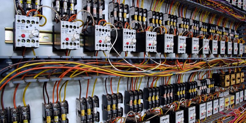

In freshman-level introductory circuit classes, wires are assumed to have no resistance. For theoretical calculations, this is useful; the student can focus on the electrical components rather than worrying about the wires. In the physical world, however, wires do indeed have resistance, and the distance between components matters.
For DC circuits, the resistance is expressed as the resistance per unit length, called resistivity. Not only does the length of the wire matter, but the diameter of the wire is also a factor. There are tables that express the resistivity of different gauge wires. When modeling these wires in a theoretical circuit, they can be modeled as an additional series resistance, where the resistor value is the resistivity per unit length multiplied by the length of the wire in that branch. Where this resistor is located in a branch is of no importance - the current must flow through all components in the branch.
Control wiring
Figure 3. Control circuits must be carefully designed with proper wire sizes to reduce voltage losses, but also to minimize cost. Image used courtesy of Canva
In the context of system wiring, the appropriate wire gauge, material, and strand count must be carefully matched with the projected current, or the power dissipation of the wire itself will lead to damage and failure of the load.

    Might want to check your claim on your tongue being 30 milliohm resistance.  I’ll bet money the voltage drop at the battery terminals when you lick it is negligible, all that resistance that make it not dangerous is primarily your tongue, not the battery.  I’d say you’d probably have a current of a few milliamps, so you do the math on that and you’ll end up with a power dissipation of MICROWATTS, which the batter can supply for a very long time
