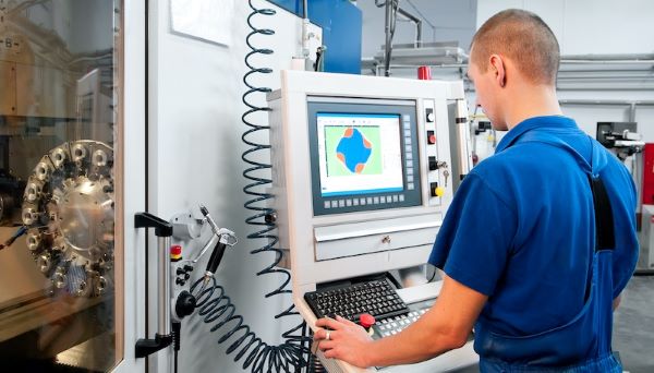

Figure 1. A technician programs a CNC controller.
