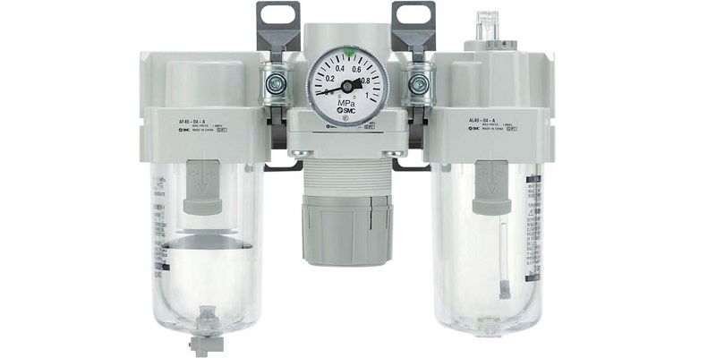

  • Air preparation unit or FRL (filter, pressure regulator, and lubricator)

Air FRL combination
Figure 1. Air filter regulator lubricator (FRL) component set. Image used courtesy of SMC

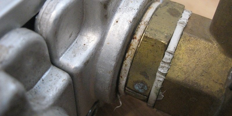

The primary problem caused by moisture is corrosion. Corrosion is the chemical reaction between metal, water, and oxygen. The tanks used to store compressed air are mostly metal. This is the perfect environment for corrosion. In the process of corrosion, metal atoms are oxidized then the water transports the oxidized metal away from the surface, leading to deeper rust cavities. For compressed air systems, the presence of moisture will cause corrosion in air compressor motors, tanks, fittings, and valves. It can also corrode electrical and electronic components associated with the pneumatic system. Water can also pick up other contaminants such as oil and dirt, which clogs various components of pneumatic systems.
Pneumatic fitting corrosion
Figure 2. Corrosion can occur externally (exposure to outside air) or internally from moisture inside the air system.

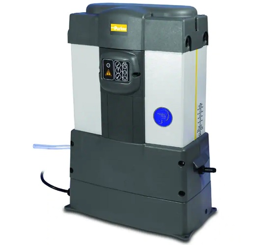

Desiccant dryer
Figure 3. Desiccant dryer system. Image used courtesy of Parker
Absorption drying
Materials capable of absorbing moisture from the air are used to dry compressed air. Absorption drying is also called desiccant drying as desiccant beads are usually used for drying. A desiccant is a hygroscopic substance that helps to maintain dryness in an area. The most commonly used desiccant substances are silica gel and activated alumina.
