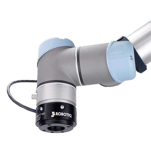

A Robotiq force sensor on a Universal Robots arm. Image courtesy of Universal Robots

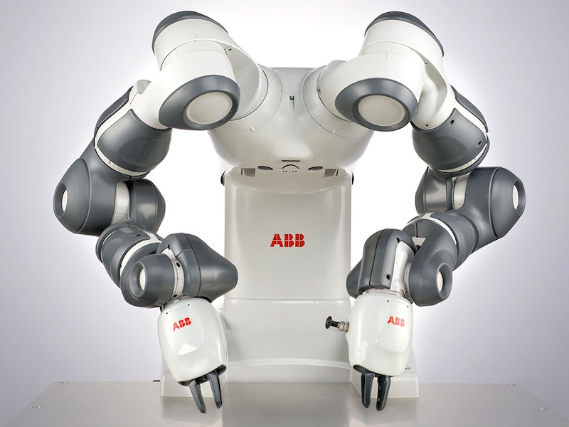

Some robots come standard with force and torque sensors built into the robotic arm itself. ABB's YuMi robot is one example of a collaborative robot that uses torque values in its operation.
ABB's YuMi robot. Image courtesy of ABB
It uses motor torque values to operate safely near human workers. If the controller sees a torque spike in the motors over a certain value, it stops the YuMi's operation. This allows the robot to work in the same space as workers without a protective safety fence.
Users can also program the robot to change actions when it sees certain force values in its routine. For example, when picking and placing objects, the fingers will know a part has been successfully grabbed when the gripping fingers see a preset force value.
With this information, the YuMi can make decisions for pick and place operations and assembly operations. The robot can confirm a successful assembly when a certain force is achieved during the assembly process. For example, dowel placement in a part, when the dowel has bottomed out in its sleeve, the torque value on the arm will spike, letting the controller know the part has been placed correctly.

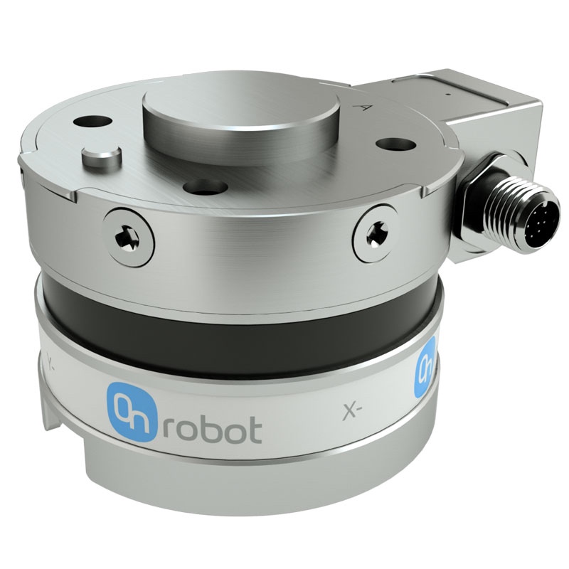

OnRobot's force/torque sensor. Image courtesy of OnRobot.
They are equipped with torque overload capabilities that alert the robot to stop moving in the event of a collision. For use in the actual manufacturing process, an external sensor must be added.
The most common type of force-torque sensor is a six-axis detector. It attaches to the end of the robotic arm, and the EOAT (End Of Arm Tool) attaches to the sensor. Whenever the tool experiences a change in force, the sensor will detect it since the tool directly links the tool to the robotic arm.
A load cell or strain gauge sensors are the most common type of force sensor. They work by measuring the strain created in the sensor when a force is applied. The strain in the sensor is then relayed to the controller so it can make adjustments to the process.
Another common type of force sensor is an optical force sensor. These force sensors work similarly to strain gauge sensors, but instead of a strain gauge reading the deformation of the sensing element, infrared light is used with a similar effect.
As the sensor is deformed infrared light detects the slightest change in force. It is so accurate it can sense human touch. These sensors are used where extreme accuracy is necessary.
