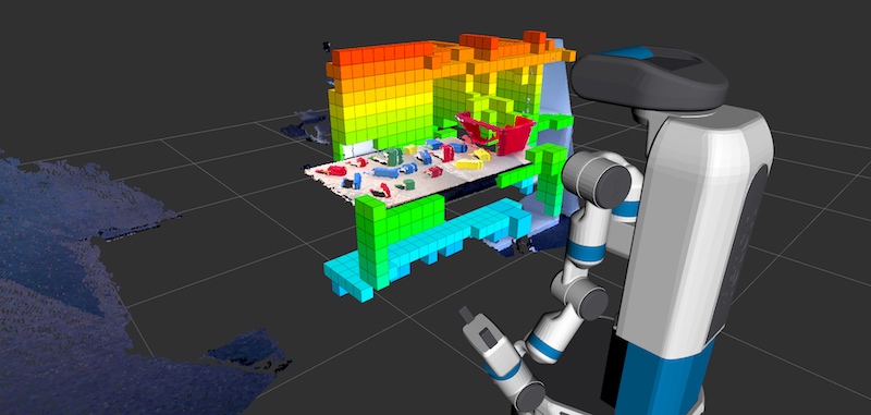

A robot utilizing motion planning technology. Image used courtesy of Fetch Robotics
Robots with kinetic chains have multiple joints that can move and rotate. For each generalized coordinate, the robot can have multiple configurations of the positions of each joint. The configuration space will depend on the perspective of calculations. Configuration space can be from the perspective of the whole robot with its many joints.
In that case, configuration space consists of the position and location of all the linkages of the robot. Another way to think about the configuration space is from the perspective of just the robot's end-effector without considering the rest of the robot. This only applies when one has considered the position and location of the end-effector.

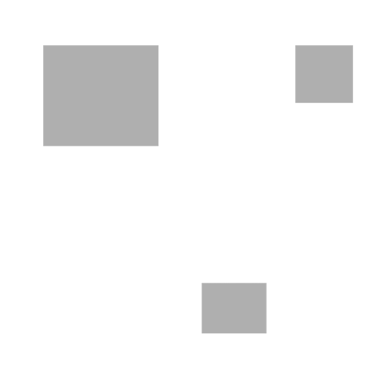

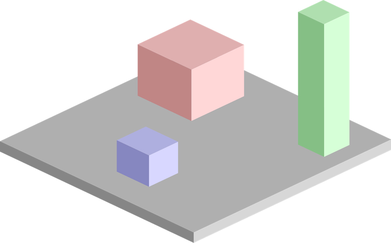

The area which it can traverse can be represented as a rectangle. In the initial step, let us consider that the robot's end-effector can be represented as a single point in the space. There are some obstacles in the configuration space too. A pictorial representation is given below.
Example of a robot's workspace. Image used courtesy of Simeon87
This is a space with three obstacles. The entire space, including the obstacles, constitutes all possible configurations of the robot and is the configuration space, C. The top view of the configuration space is like the image given below and is a two-dimensional plane.

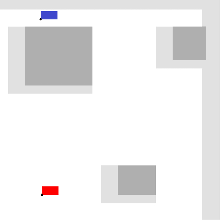

The dark grey rectangles represent the obstacles, and the rest of the space is free space available for the robotic arm to move in. Image used courtesy of Simeon87
Now imagine an end-effector has to be moved from one position to another. Let the blue rectangle show the initial position, and the red rectangle show the final desired position of the end-effector.
The end-effector is not a single point, but it is a thick tool in a rectangular shape. The black dot at the lower corner of the effector is taken as the point that is to be moved. When the width and height of the effector are to be considered, and additional space has to be left around the obstacles and the periphery. This way, no part of the end-effector touches it. It is indicated by the light gray portion in the image.
Here:
C = The complete space in the image
Cobs = The light grey and dark grey area in the image
Ctarget = The red area in the image
Cfree = The white space in the image
