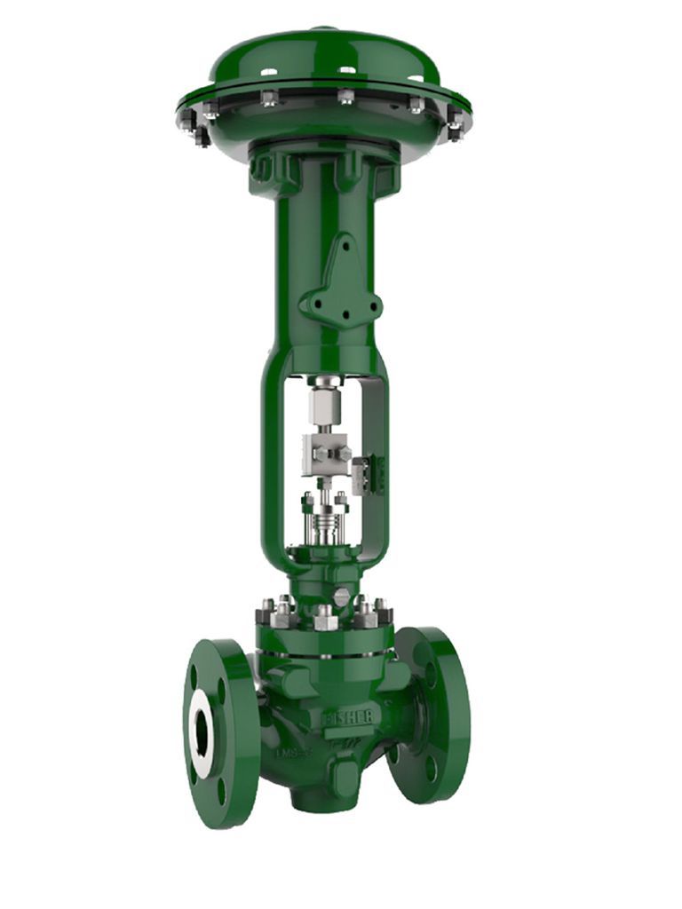

A globe valve
Figure 1. A globe valve. Image used courtesy of Emerson
