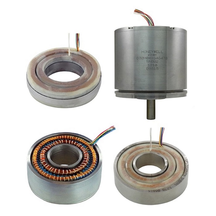

Resolvers are rugged beasts. They are analog devices that contain no onboard solid-state electronics or optics. This design makes the resolver an exceptionally robust piece of hardware that performs well in harsh environments where high temperatures, shock, vibration, radiation, and contamination may occur.
Figure 1. 3-inch series resolver with multiple housing & rotary transformer configurations. Image used courtesy of Honeywell
Resolvers are already being used in many common applications, especially in industries where these conditions tend to exist, such as oil & gas, energy, steel mills, and elsewhere.
Resolvers are cleverly engineered rotary power transformers with an output voltage that can be varied magnetically by rotating the resolver’s rotor within a stator. The multiple windings of the transformers are constructed so that with one full rotation of the resolver’s rotor, one full sine wave and one full cosine wave are generated as outputs (or multiples of these in the case of multi-speed resolvers).
Also known technically as an “analog trigonometric function generator,” resolvers aim to resolve the input vector into its sine and cosine components – where the rotor position can be found as the arctangent of these two output voltages.

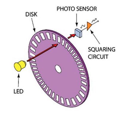

Let’s consider a typical optical encoder. The basic idea is that there’s a perforated plate on the rotor with a light on one side and an optical sensor on the other.
Figure 2. Components of a typical optical encoder. Image used courtesy of the Electrical Engineering and Computer Science (EECS), University of Michigan
As the rotor turns, the sensor’s output will vary from high to low as the perforations pass over it, allowing light to pass through to it. By counting the number of high and low pulses, the distance traveled can be determined.

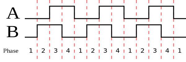

Determining the direction the plate is turning is achieved by quadrature. The light beam is measured by two parallel sensors. The intensity of the light onto one of the sensors will increase before the other sensor.
By comparing which sensor’s output goes high first, the direction is known. These two signals are referred to as A and B channels. The inverse of these, A’ and B’, are also given dedicated channels, and their data is used as a check against transmission errors from A and B.
Figure 3. Two square waves in quadrature. The direction of rotation is indicated by the sign of the A-B phase angle which, in this case, is negative because A trails B.Image used courtesy of Sagsaw
In total, four channels are created hence the term quadrature.

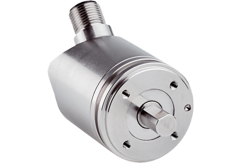

Some applications need to always know where home is, even immediately open a system power restart. For these applications where performing a homing routine is not practical or possible, absolute encoders may be used. There are multiple types of absolute encoders that use different technologies to keep track of home even after a power restart.
An absolute encoder. Image used courtesy of SICK AG
Some absolute encoders produce an additional Z channel in addition to channels A and B, where Z is specifically dedicated to keeping track of how many revolutions the encoder shaft is from its home position. Even if the shaft is moved while power is removed, an absolute encoder will know its position when power is restored. Due to comparatively high cost, incremental encoders are sometimes chosen over absolute ones.
