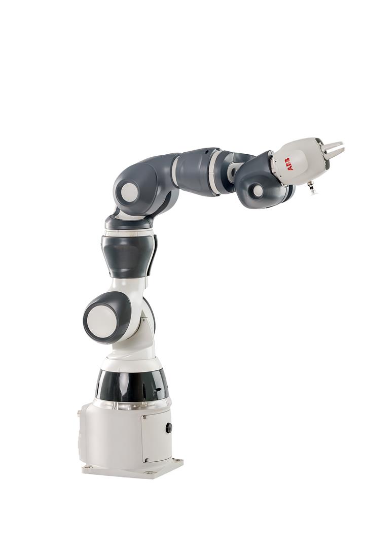

Robotic arm from ABB
Robotic arm made by ABB. Image used courtesy of ABB.
