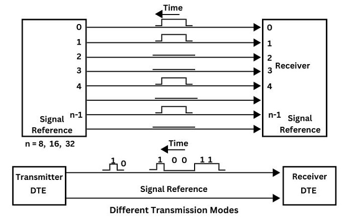

Effective communication between DTE <-> DTE depends on the methodology which relies on factors like distance between devices, required speed, and maximum cost. As already stated, the distance over which both parties communicate determines whether parallel or serial communication should be employed. Almost all communication is parallel inside the computer while external computer-computer communication is usually serial.
Parallel communication is used over short distances, which means that the entire integer, whether byte, word, or long word, is transmitted at the same time. Either 8, 16, or 32 conductors must be used (respective to the integer size), but this would make the parallel transmission very expensive over a long distance, although it would be fast. The optimal solution over long distances, then, is serial communication. In serial communication, only one bit is transmitted at a time. Hardware-wise, only 2 or 4 wires are required, but the transmission speed becomes significantly lower.
Parallel vs serial modes
Figure 1. Parallel vs. serial transmission modes between the sending and receiving devices. Image used courtesy of the author

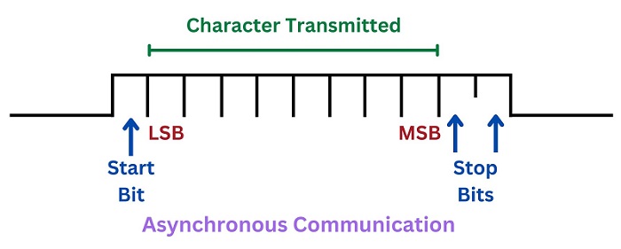

Asynchronous Communication
This sort of communication is employed when the communication takes place at random times, such as between a user tapping a keyboard and the computer. The time between any two transmission cycles is of random length. The two devices must be synchronized to establish communication. This can be achieved by the transmitter sending a character message that includes a leading start bit to indicate that useful data is about to follow, as in Figure 2.
Asynchronous communication
Figure 2. The structure of an asynchronous data transmission, with start and stop bits shown.
The two stop bits mark the end of the message. When the receiver reads the character, the two parties must be synchronized again as a part of the transmission of the next character. This method of synchronization is called character synchronization.

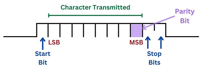

Parity Checking
It is the most common type of error-checking technique on data that is transmitted in small portions. The parity checking means the sender calculates the sum of ones in the message to be transmitted. If this sum is an even number then even parity is employed, and the parity bit is set high. In case of odd parity, the parity bit is set low. This parity bit (even or odd parity bit) is then appended to the message for transmission as in Figure 3.
Parity bit in a byte (or word)
Figure 3. The parity bit is the 8th or final bit of the byte.
The parity bit then enables the receiver to check the sum of bits and compare it with the parity bit to ascertain whether any error has been detected.

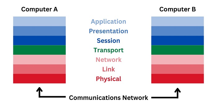

To facilitate the development of protocols, the International Standards Organization (IOS), at the end of the 1970s, defined a reference model for standard communication protocols. This model became known as the ISO reference Model for Open system Interconnection (OSI) and described a structured approach to data communication, Ever since, this model has had a strong impact on the computer and data communication industries. Nowadays, all networks are based on this model to a larger or lesser extent.
7-layer OSI model
Figure 4. The reference model for Open System Interconnection (OSI).
The model divides the logical structure into seven layers. The three lowest layers are dependent on the network, while the three uppermost are linked to the application. The middle layer, the transport layer, constitutes an interface between the upper and the lower layers. In sum, each layer communicates with the corresponding layers in another computer.
Following are examples of applications that employ the OSI model for communication:
  • Remote terminals read process field data and transmit it to a central system.
  • The communication between the two centers
  • Workstations fetching and sending files from or to a file server
