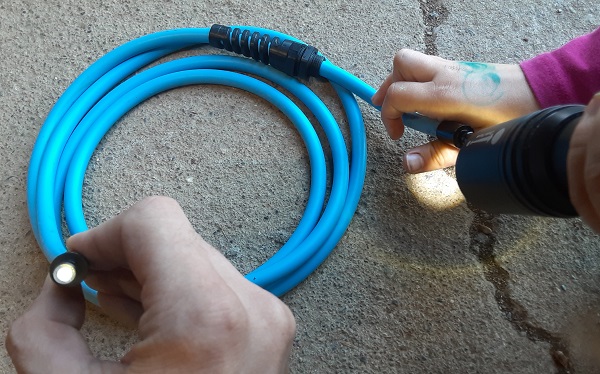

Demonstrating fiber optic light transmission
Figure 1. Demonstration of light transmitted through a coiled fiber optic cable. Image used courtesy of Control.com's Director of Engineering Content and his junior assistant

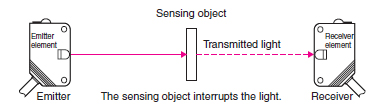

Through-Beam
This style of sensor consists of an emitter and receiver, the emitter sends out a beam of light that the receiver detects. If an object blocks the receiver, the signal is lost. Then once the object leaves, the light is once again detected at the receiver.
Thru-beam optical sensor
Figure 2. Through-beam optical sensor. Image used courtesy of Omron
These sensors work well in applications with long ranges and have a high gain which works well in dusty or foggy environments. Alignment of sensors can be time-consuming and vibrations can cause alignment to drift over time.

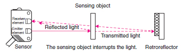

Retro-Reflective
A retro-reflective sensor still has an emitter but uses a reflector to bounce the light back to the emitter. Like the through-beam, when an object blocks the light, the sensor no longer outputs a signal.
Retro-reflective sensor
Figure 3. Retro-reflective optical sensor. Image used courtesy of Omron
These sensors work well in applications where the color or angle of an object needs to be detected. For example, a retro-reflector sensor can detect transparent objects such as plastic or glass. These sensors work best at longer ranges, closer ranges will not detect objects at all.

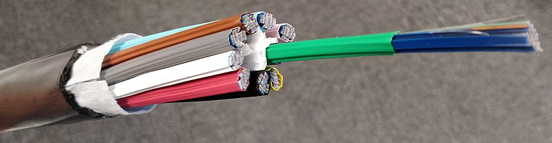

Cutaway view of a fiber optic cable
Figure 5. Close-up view of the inside of a fiber optic bundle. Image used courtesy of Wikipedia
Fiber Optic Cable
A fiber optic cable is a very thin filament that is drawn from molten glass or plastic. This hair-like substance has the ability to transmit light with very low attenuation. Fiber optic cable is commonly used in the telecommunications industry. In fact, a special fiber optic cable spans across the Atlantic Ocean to provide internet and phone communications between North America and Europe. This application combines multiple fibers to transmit multiple light sources over a great distance. In automation applications, fiber optic is used a bit differently but with the same ‘conductive’ medium.

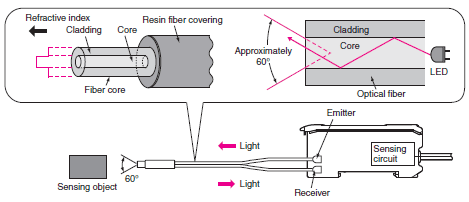

Inside a fiber optic sensor
Figure 6. Fiber optic concept applied to a photoelectric sensor. Image courtesy of Omron
Fiber Optic Sensors
In the realm of automation, fiber optic cables are used to transmit light through as few filaments as possible and usually over a fairly short distance. A typical fiber optic sensor will consist of an amplifier that handles emitting the light and displaying the received light intensity. The fiber head itself may be a single head or a split (Y-shaped) cable to accommodate both sending and receiving signals, as seen in the lower part of Fig 6.

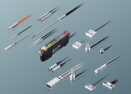

There are single fiber heads that act like a diffuse sensor, and there are through-beam-like heads that consist of an emitter and receiver. The fiber heads can be mounted in many different ways and typically have a standard-sized thread on the body of the head. Some heads are cylindrical, while some are square or mounted in a small bolt. Some manufacturers even have miniaturized sensors that measure less than 1 mm in diameter.
Fiber optic sensor variants
Figure 7. A wide variety of fiber optic sensors. Image used courtesy of Keyence
