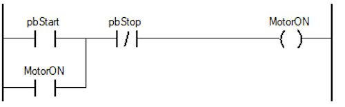

Ladder logic was the first language used with PLCs. It was intended to represent an electrical digram because the PLC was designed to replace large electrical panels with hundreds of relays. The ladder language is a graphical language that is easy to read and is used throughout the world as a standard for machine automation.
LADDER LOGIC
Figure 3. A graphical language ladder logic example. In this PLC language, electrical contact symbols represent inputs and boolean variables, and coils represent outputs. A MOVE instruction (MOV) is represented by a block.
Inputs and boolean variables are represented with a contact electrical symbol, while outputs are represented with a coil. More complicated functions, like a MOVE instruction—which moves data from one variable to another—are represented by a block with a title; MOV, for example, for the move instruction.

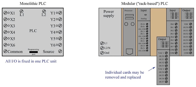

PLCs were designed to use ladder logic; for a time, it was the only language you could use on a PLC. Some PLC manufacturers have included sequencer function blocks, and most recently, FOR loop function blocks.
Figure 4. Different PLC types with multiple inputs and outputs.
Ladder logic works well for simple automation. Just about anybody can easily understand it, it’s highly flexible, and it’s easy to troubleshoot with the graphical representation of syntax.

    One note , the two code snippets are almost functionally the same but is bot start and stop buttons are both on in the ladder code the motor will be off but in the ST code shown the motor would be On
    easlier changed by using this
    IF pbStop THEN
    MotorON := 0;
    ELSIF pbStStart THEN
          MotorON := 1;
    END_IF;
    OR
    if pbStart then MotorOn:=1;end_if;
    if pbStop then MotorOn:=0;end_if
