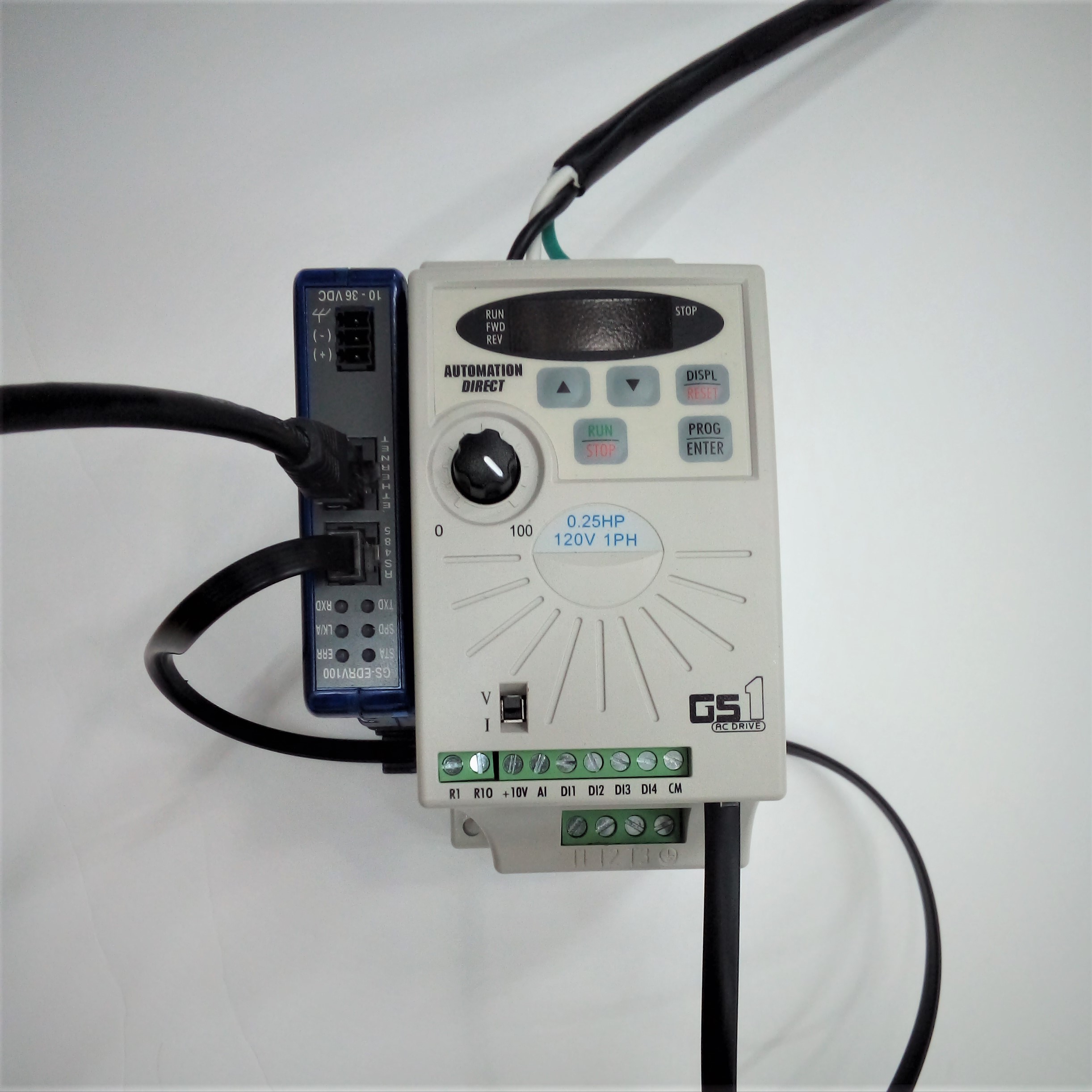

Figure 1. Many end devices, such as this VFD, require an adapter (the blue device) to take the application data of normal Modbus and wrap it up in the physical and transmission standards of Ethernet TCP/IP.

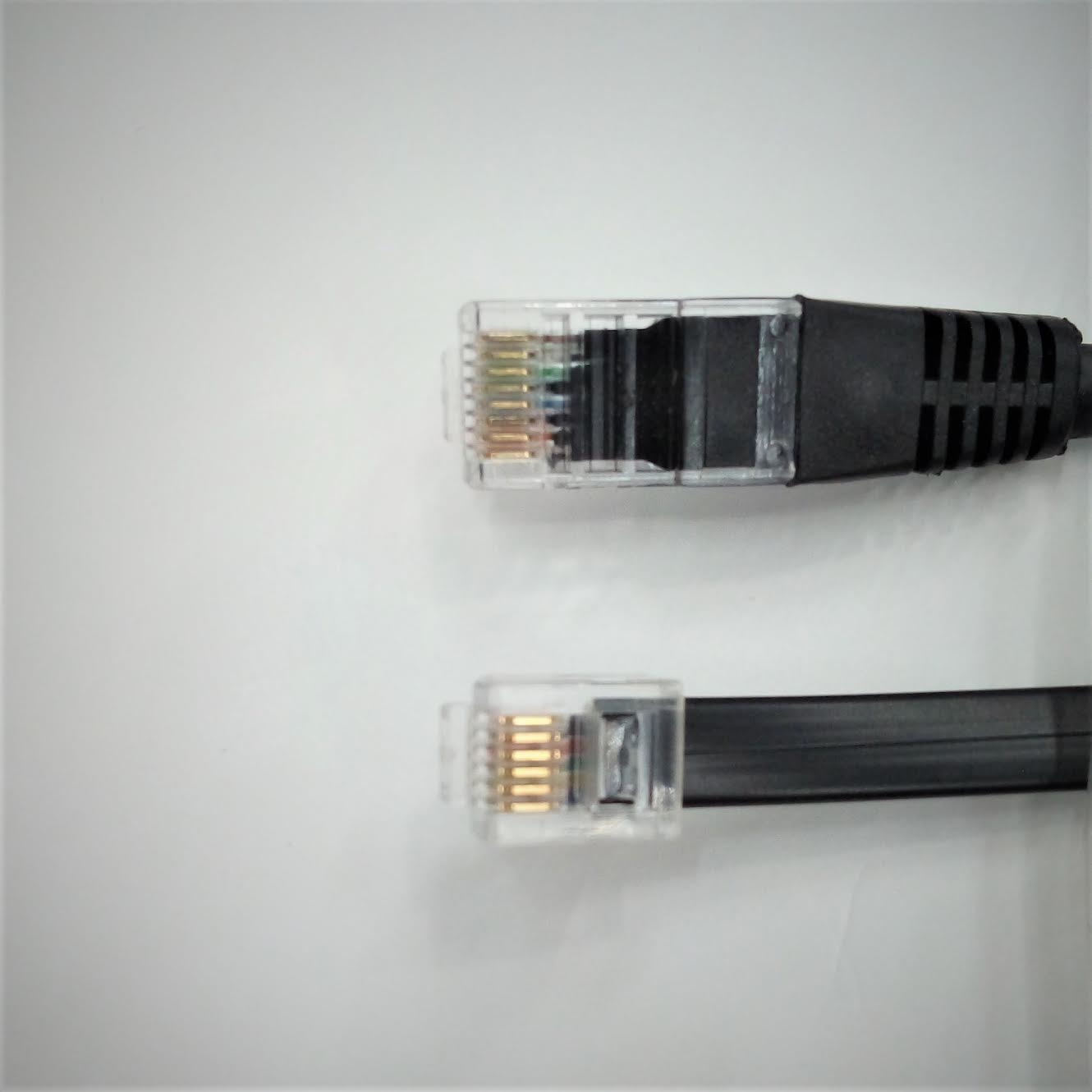

Ethernet Connector and Cable Types
The connector is quite recognizable as a square plastic plug with eight metal contacts and a locking tab. This is the Registered Jack 45 (RJ45). It appears in nearly all modern industrial processor-based equipment, although again, sometimes requires an add-on module.
Figure 2. A subtle but critical difference in the physical connectors - the larger 8-pin RJ45 at the top is for the Ethernet TCP/IP connection, but the smaller 6-pin RJ12 at the bottom is for the Modbus connection. Profinet is always RJ45.

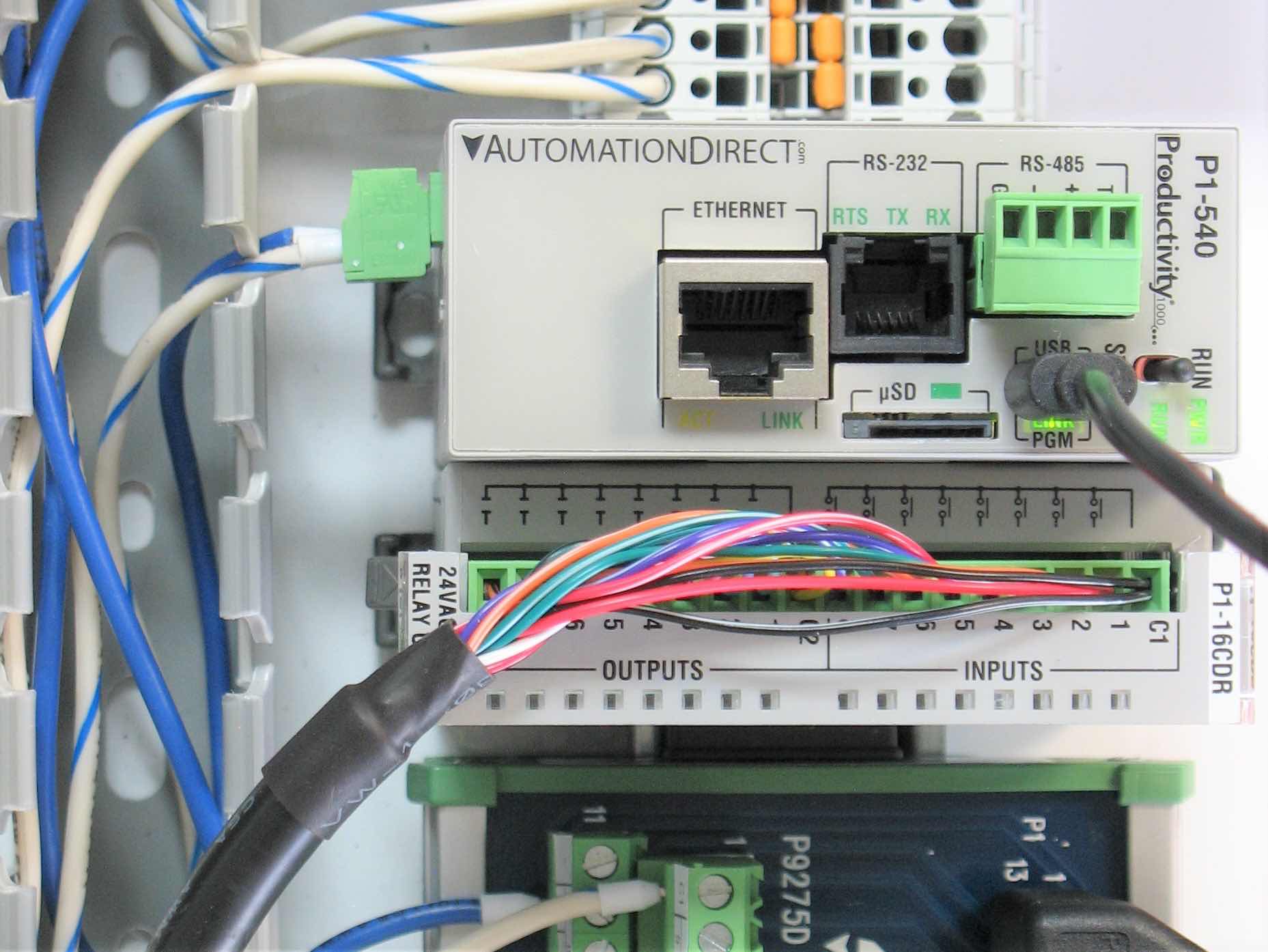

Figure 3. This PLC allows device connections for Ethernet using TCP/IP standards and an RS-485 for Modbus-specific communication.
