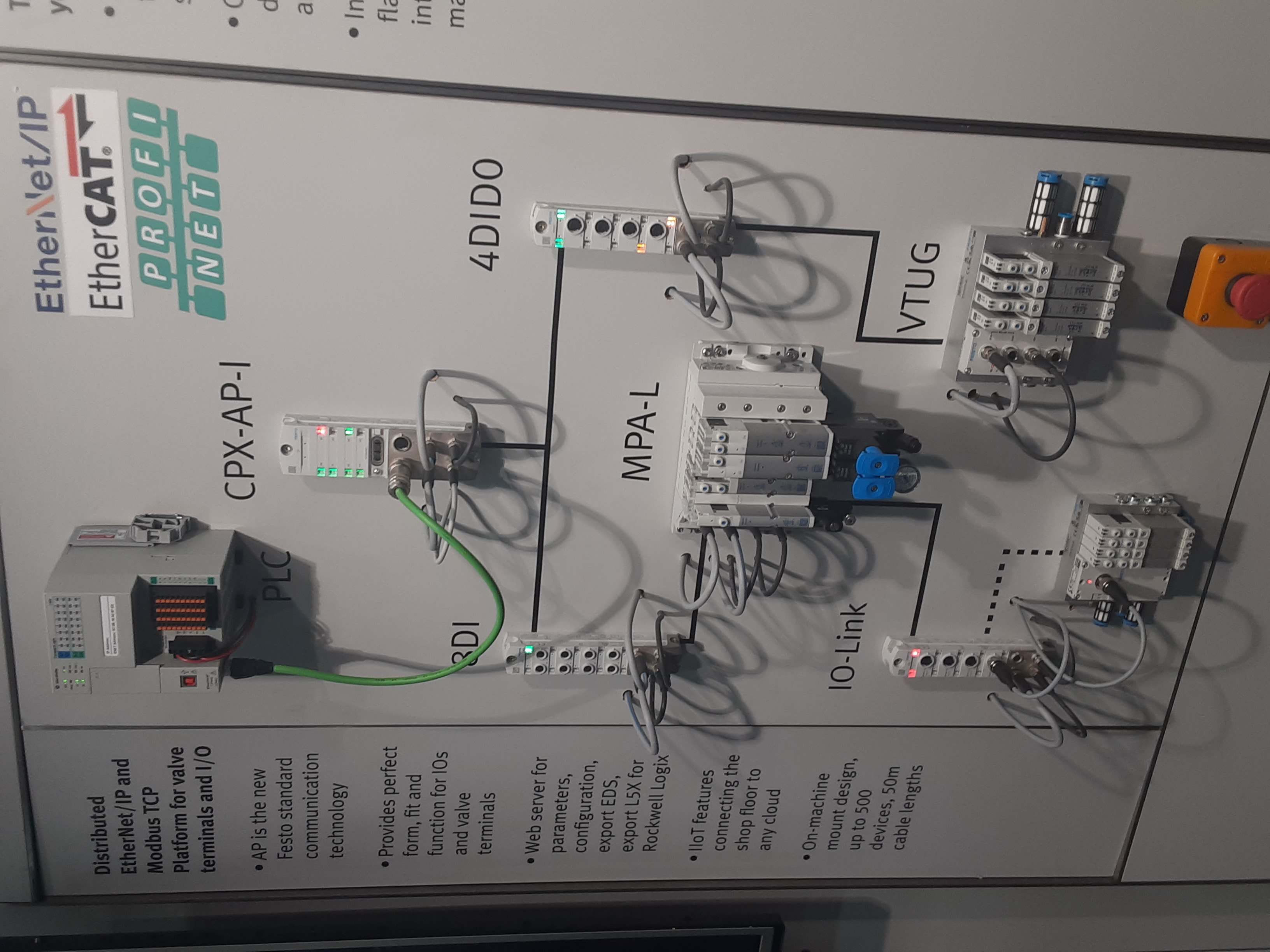

Festo CPX demonstration from Automate 2022
Figure 2. Festo CPX demonstration using distributed Ethernet/IP and Modbus TCP for valve terminals and I/Os from Automate 2022. Image supplied by Control.com

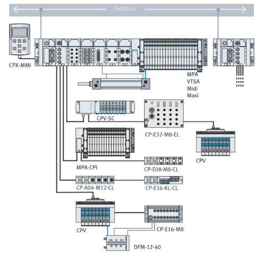

Festo's CPX-XP control architecture
Figure 3. The control architecture of Festo’s flexible CPX-CP system allows for multiple input and output blocks on the same network address. Image courtesy of Festo
Distributed I/O System
Some manufacturers have a distributed I/O system that is customizable and flexible that connects multiple groups of input sensors and pneumatic valves to one node on the industrial Ethernet network. Festo has developed the CPX-CP system which allows multiple inputs and outputs to be connected to the same network. The CPX-CP system is flexible by design because you can add additional I/O strings that provide chaining of multiple input and output blocks all with the same network address.
In this context, Festo defines a ‘string’ in the CPX system as the cables and modules connecting to one single CP master’s connection point. In other words, a networked branch circuit.
Application
Festo’s style of distributed I/O works well with many input and output requirements spread over a large area. If we were to use isolated individual valve banks we would occupy many IP addresses and connections. Today, this can be very costly as many devices require IP configurations over Ethernet. If we use, for example, three robotic assembly cells all requiring networked I/O controlled by the same PLC, we could use a single distributed I/O system and run one string which consists of inputs and outputs to each robot.
With the CPX-CP system, each string will give you 32 inputs and 32 outputs which is plenty for a robot application. In the PLC, we would only require one item in the network tree, meaning only one IP address and one connection for three robots. This not only saves us on network overhead but also with wiring as each string is only one cable.
