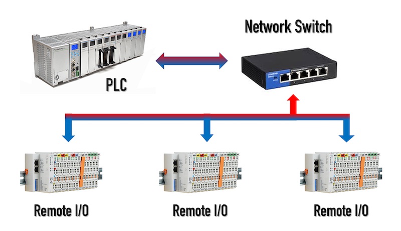

A diagram of a typical structure of a remote networked input/output system.
The typical structure of a remote networked input/output system.

Networking cables are capable of sending complex streams of data over 300 ft in the case of standard network cables, and much longer in the case of fiber optic. Complex combinations of digital and analog input/output data can be sent over hundreds of feet very quickly. The concept of remote I/O is simply to place a distribution point at the end of these network cables which can collect sensor signals, then transmit them over the network to a single processor. They can also receive commands from that center processor and complete tasks of their own.

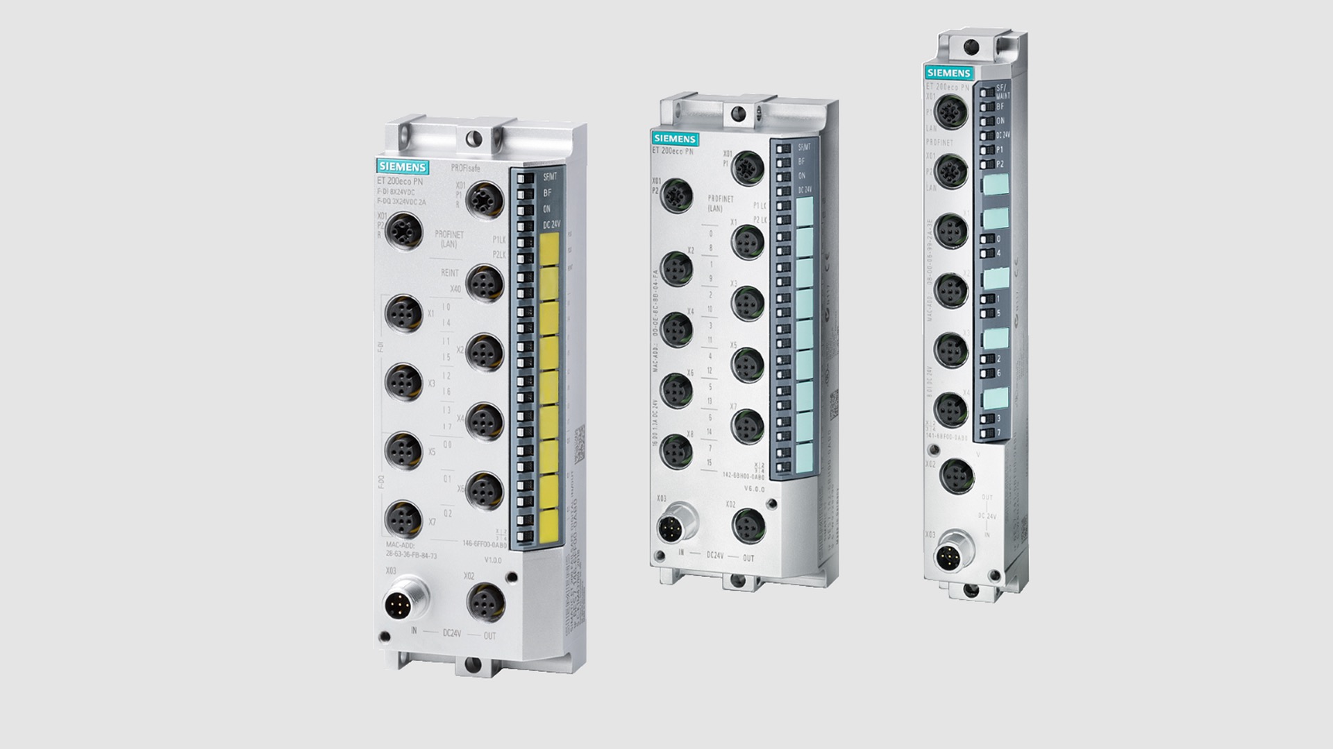

Siemens ET200 Series IO.
Siemens ET200 series IO which can be mounted on a machine without a cabinet or enclosure. Image used courtesy of Siemens.
This capability allows us to build a giant network of sensors and output devices, and operate them over long distance network cables, all being operated from a single central processor.
An important consideration would be to establish a very consistent addressing system that assigned each group of machines with its own set of network addresses (IP Addresses for an Ethernet system). This allows the technicians to track down problems very quickly based on device address, and also allows rapid deployment of new machine centers simply by adding another network distribution point and set of network addresses. Establish that new single network connection with a cable, and the entire machine center is operational - rapid deployment!

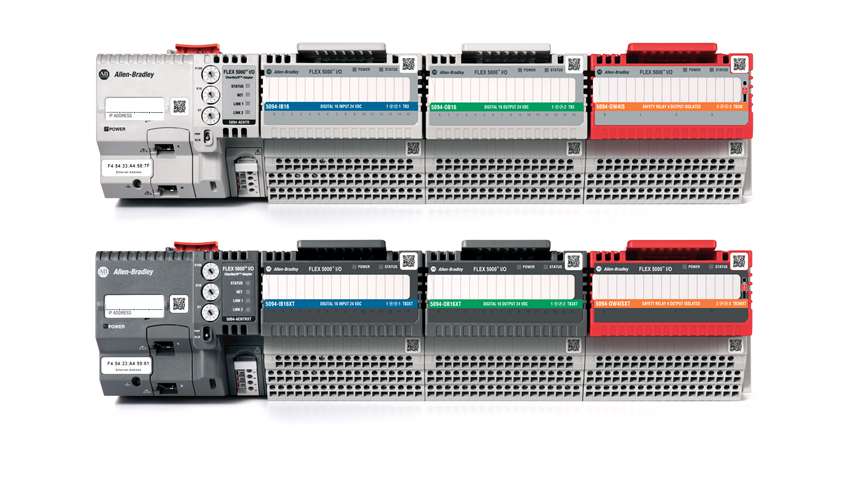

Usually, this will be a PLC with an Ethernet or a DeviceNet connection. Each of the Network or Remote I/O devices will consist of the network cable incoming, with a number of wiring points for the sensors and relays and other I/O devices.
Sometimes only half a dozen of these ports, but other times it may have over 100 points, depending on the scale of the machine. Usually, these ‘points’ will take the form of screw terminals for +24v, GND and the signal, where other times they might be a 5-pin Quick-Disconnect cable terminal.
Rockwell Automation Flex I/O. These systems have a variety of communication adapters, inputs, outputs, and specialty modules. Image used courtesy of Rockwell Automation
