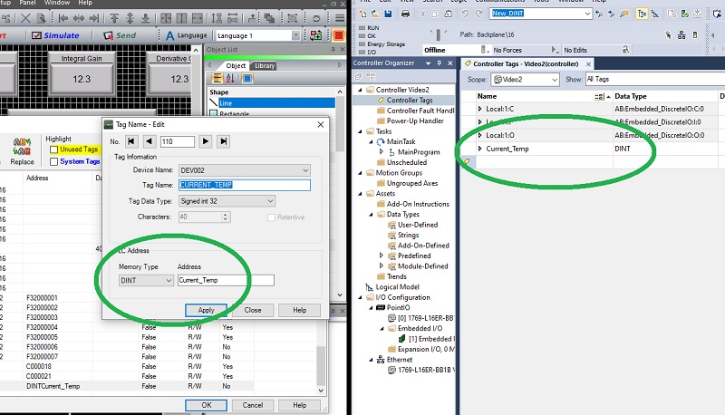

Tags defined in the HMI and the PLC
Figure 2. A 32-bit DINT named “Current_Temp” defined in the HMI software (Left) and similarly defined in the RSLogix Controller Tags (right)

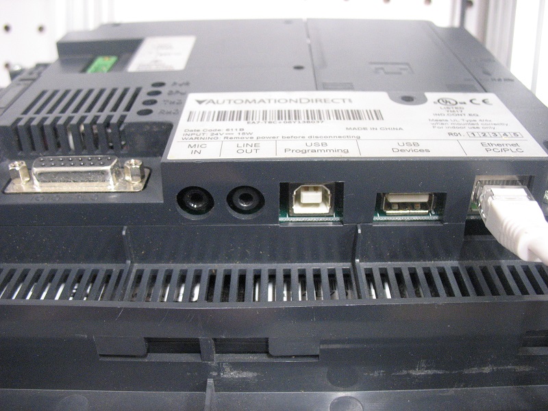

First: the communication protocol. HMIs are designed with a wide variety of network interfaces—the standard being Ethernet, RS-232, or RS-485, but often with adapters for several others. You must be able to select your own PLC and be aware of its network connection protocol. Finally, most screens are limited in the number of simultaneous connections, but they usually allow more than just one.
Multiple communication ports
Figure 3. Various HMI communication and programming ports

In Allen Bradley Compact/ControlLogix architecture, the structure is by tag name. Each tag created by the user has a unique name, rather than a number. This can simplify the process, as long as the PLC designer assigned logical names to the tags. An example of this tag name method is illustrated in Fig 2.

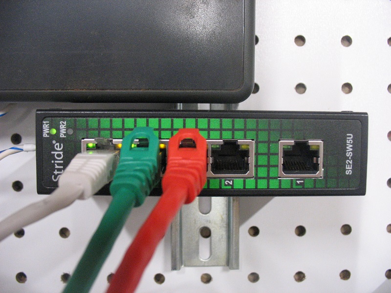

Network switch for multiple devices on a single network
Figure 4. The network switch allows multiple machines to connect to an HMI with only a single Ethernet port
