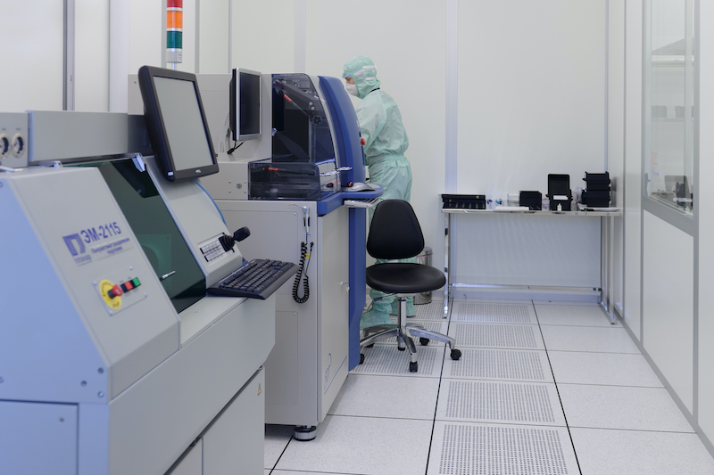

A cleanroom’s environment is controlled so that it has a limited number of particles in the air. Particles cause contamination so they must be limited. That means that the particles are filtered out or restricted from ever entering the cleanroom. Particles can come from dust and bacteria and air clarity is affected by the temperature and humidity in the room.
Figure 1. A cleanroom contains an extremely limited number of particles in the air to ensure sterile manufacturing and production.

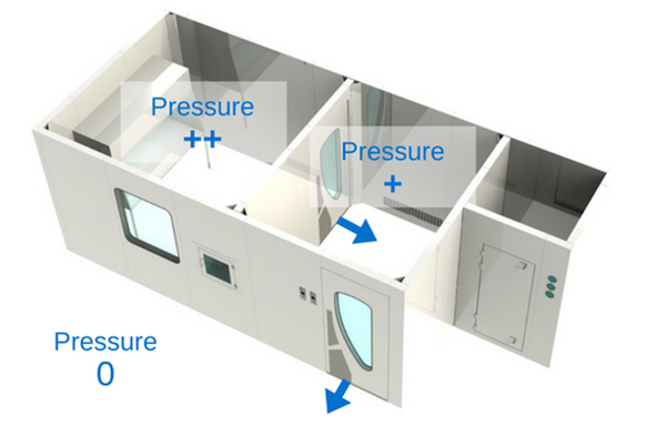

Differential pressure sensors measure the difference between two points, not the actual or absolute pressure. In cleanroom technology, the area inside the cleanroom should be at a positive pressure and the area outside should be negative. This is because positive pressure prevents foreign particles from going into the controlled area.
For cleanrooms, the area inside should be at a positive pressure and the area outside should be at a negative pressure.
Figure 2. For cleanrooms, the area inside should be at a positive pressure and the area outside should be at negative pressure. Image courtesy of Cleanroom Technology.
A differential pressure sensor monitors for positive pressure in the controlled area and alerts the system if the differential pressure goes negative. These are also used in the filter assembly of the clean rooms. Its purpose is to measure the condition of the filter indicating the effectiveness of its filtering capability. In this case, it is installed across both faces of the filter.

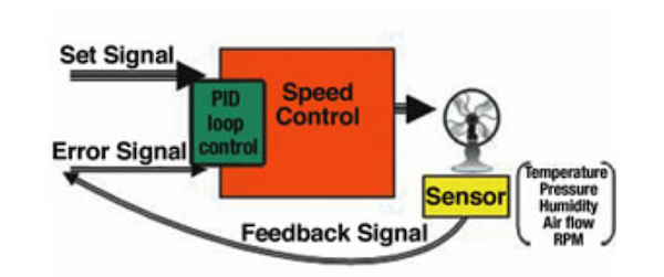

  • Control the fan speed to supply the desired airflow. The feedback is given by airflow sensors. They monitor the physical value with the set value. Any change in the sensory value causes an increase or decrease in the fan speed.
  • Monitor environmental conditions like temperature and humidity. Any change in the preset value can trigger an alarm or stop the process.
closed loop control using external sensors
Figure 3. The control system algorithms used must control and monitor a variety of components. Here is an example of a closed-loop control using external sensors. Image courtesy of Cleanroom Technology.
