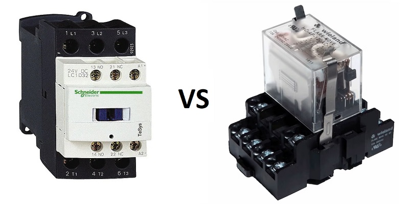

Figure 1. Relays and contactors, although they both work on the principle of magnetic field action, are very different components.

Figure 2. Contactors are usually larger than their relay counterparts. Image used courtesy of Iskara

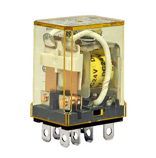

Control relays can be designed to be normally closed (NC) or normally open (NO). For normally open relays, the main circuit is open when the control circuit is not energized. The main circuit closes when the control circuit is powered. For normally closed relays, the main circuit is closed when the control circuit is not energized. The main circuit opens when the control circuit is powered.
Figure 3. This relay has two poles, each with a normally open and closed, making it a double-pole-double-throw (DPDT). Image used courtesy of IDEC

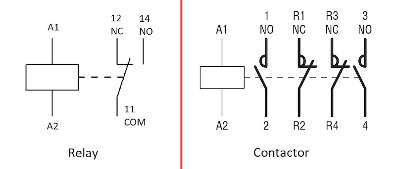

The symbol for the respective devices is shown below:
Figure 4. The symbol for a relay (left) and for a contactor (right).
