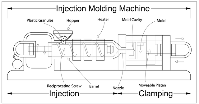

The injection molding process has several basic steps: material preparation, injection, mold release, and quality assurance. Even though this is a mature manufacturing process, each step has its challenges and benefits from both automation and increasingly smarter industrial control.

The first series of steps in the injection molding process involves batching, blending, and heating the raw materials. Plastic beads or shreds of recycled plastic are fed into a mixing hopper. The size, shape, composition, and color of the beads will impact the final product. Bead colors are often mixed to achieve the desired color; however, plasticizers may be added to improve flow properties and uniformity, and so on.
One area that has benefitted from machine vision is color matching and uniformity. Before machine vision, some parts would have minor variations in color, as the colors were selected by recipe rather than through real-time measurements. Conversely, with well-trained machine vision, the colors can be altered during mixing so that the part-to-part color variation is below the detection limits of the human eye.
The beads are mixed and melted using electric heating. The heater controls use a feedback loop from either a thermocouple, thermistor, or RTD to monitor the temperature. This must be tightly controlled because plastics degrade under excessive heat, and colors will be affected differently. Some of the impurities are allowed to burn out, but precision control is needed in this step.
Furthermore, the melting often occurs in the auger barrel, headed toward the mold. This means the temperature profile through the barrel must be well-controlled and tracked to ensure that properly melted and mixed plastic is exiting the auger barrel into the injection molding dies. The system designer must integrate the auger rotation controls and heating profile.

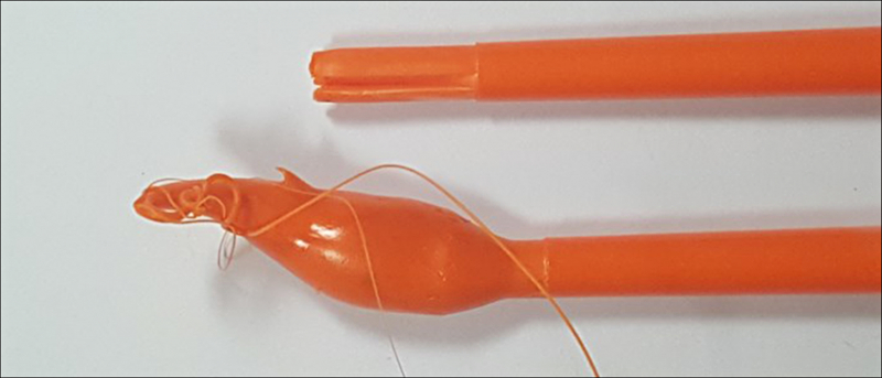

The injection pressure is important because too high of a pressure will result in excess material squirting out of multipart molds (called flash) and can also lead to stringers. Stringers, or jetting defects, are when high-pressure jets of plastic shoot into the mold, but because of their narrow width, they freeze on the outside and leave a squiggly defect in the final part. Stringers can also be limited through proper mold design—placing a feature such as a hole or pin near the nozzle will prevent long stringers from forming.
Figure 3. What a stringer looks like. Image used courtesy of Progressive Components

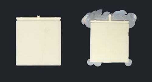

The final piece to the injection molding process is quality assurance. Parts typically receive some light machining to remove the sprue, risers, and any traces of flash. They need to be smooth enough not to cut the human hand that uses the product at a minimum, but higher quality parts will show very little mold parting line.
Figure 4. What the product should look like versus how it looks with flash. Image used courtesy of Techno-UMG Co.
The locations of the sprue, risers, and mold parting line will be the same for each material, so this control will need to be set up for each item, but then requires little maintenance. Cutting surfaces will wear and need to be replaced. Furthermore, a visual inspection that shows lots of flash means that the injection pressure is wrong or the mold surfaces are worn.
