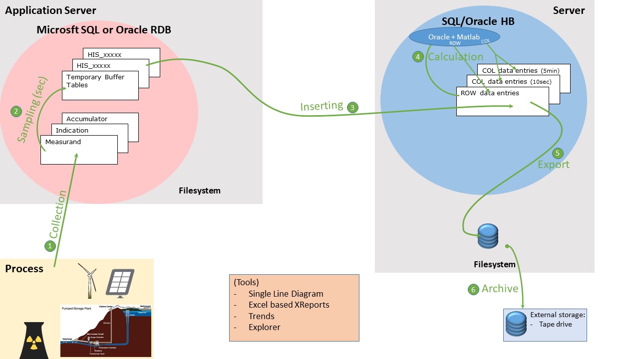

Sampling and Inserting Process: Overview
In order to get a basic understanding of how online data is stored in the historical database, let's first understand the process value life cycle:
  1. Data collection from the process to the primary database, which is often running in SCADA or application servers
  2. Data is stored in the online database, viewable to an operator via GUI displays
  3. Data is sampled to temporarily buffer tables with timestamp added
  4. Data is inserted into the Oracle/SQL database in the archiving server
  5. After some time, data is exported to a filesystem or external storage
data archiving implementation steps from process to external storage media
Figure 2. Data archiving implementation steps from process to external storage media.

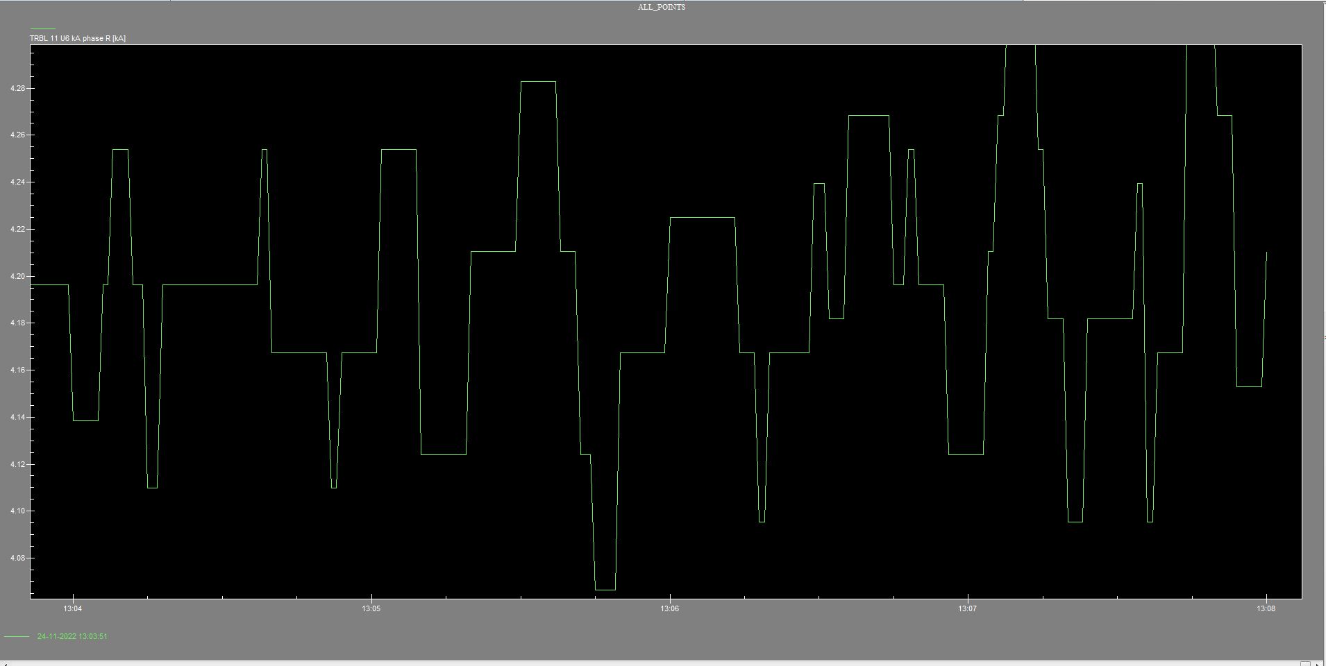

Presenting Historical Process Data
The historical process data can be located either in the main/historian database, in the file system as text files, or on secondary media like magnetic tapes. Once the database is populated, there are many ways and tools to present data to the operator.
As per Figure 2 below, when historical data is sampled, it is saved to the main database for a specific amount of time, often called the retention period (one day, one month, etc). When the retention period expires, the data is optionally exported to the file system as a text file. The exported historical data can be stored in the file system or written to external storage media like tapes. These could later be imported to restore back the database area.
trend xy curve example for ac generator-6 red phase current in kA
Figure 3. Trend XY curve example for AC generator-6 red phase current in kA.
The information in the historian server can be retrieved from different clients and with various tools with several commercial tools like browsers, reporting tools, and spreadsheet tools. It is also possible to create charts of different kinds (pie charts, bar charts, etc.) based on the retrieved data.
