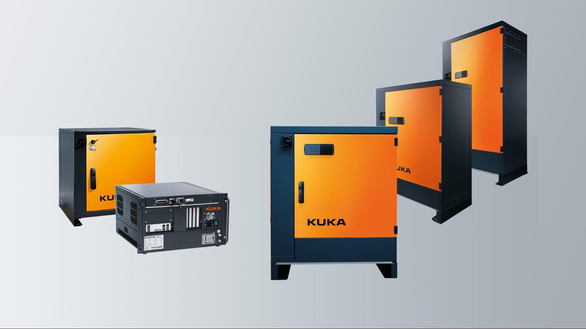

Figure 1. Various robot controllers from KUKA. Image used courtesy of KUKA
The complexity of the small robot cell is a good indicator of whether a simple controller can be used or if a more complex PLC is necessary. If the manufacturer plans on upgrading the cell in the future, or if there is any reason it might need more inputs and outputs, it is best to use a controller with more capacity than anticipated. An oversized controller allows for more flexibility within the cell long-term, thus accommodating any changes, such as adding sensors and I/O to the system.

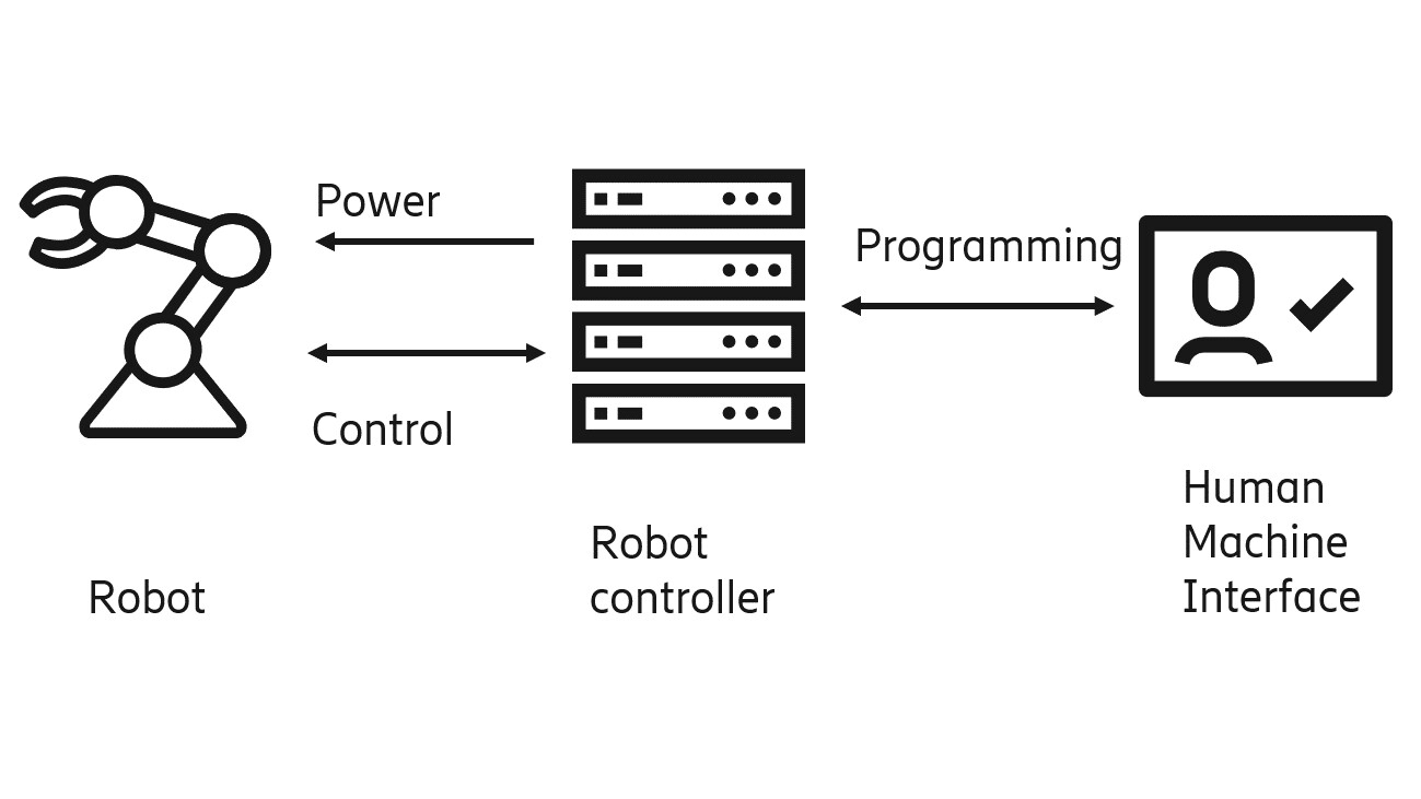

Figure 2. A diagram showing how a robot controller interacts with other controllers. Image used courtesy of Ericsson
This generally consists of a safety-rated relay connected to a PLC or a PLC with an integrated safety system. When considering safety system options, it is best to compare the price difference between a PLC in tandem with safety relays and a PLC with safety integrated because the cost difference all depends on the cell’s specifications.
