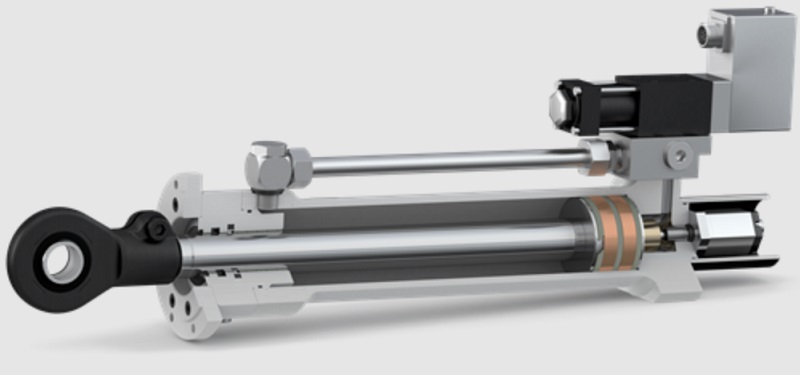

Servo hydraulic cylinder
Figure 3. Internal diagram of a servo-hydraulic valve directly mounted on an actuator. Image used courtesy of Hanchen
Electrohydraulic Servo Valve (Closed-Loop)
What if you could control the end position and the speed of an actuator accurately with a simple control signal? This is where the electrohydraulic servo valve comes in. This style of valve uses a small servo to manipulate a control valve, usually proportional to the incoming voltage or current signal. Because of the precise controllability of a servo, the position of the valve can be positioned to give excellent dynamic control of the pressure and flow of fluid. If we combine a linear position sensor with this system, we now have an accurate closed-loop system that can control the final position and speed of our actuator.
