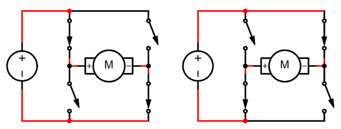

Most modern inverters utilize some form of H-Bridge circuity to change the polarity of direct current. In most cases, the lower voltage DC current needs to be amplified to match the voltage of the AC it will be supplying. The act of switching DC voltage naturally creates an alternating current because, in principle, AC power is an electrical current switching polarity at a certain frequency.
H-bridges consist of four switches that can be used to switch the polarity of a load through an H-shaped circuit, so the current can flow across the H in either direction depending on switch orientation These circuits are commonly used for reversing motor polarity, as exemplified by the circuit diagram below.
H-bridge circuit for motor control
Figure 2. A simple H-bridge circuit can be used to effectively switch direct current polarity. Image used courtesy of the author
A basic H-bridge can supply alternating current at the correct frequency, but the power output has a different waveform than what should be supplied by the electrical grid.
When DC power polarity is switched through an H-bridge, the resulting waveform is square. For some applications, square waveforms are not detrimental as long as the wave frequency is within the appropriate range, however, they can be problematic for more sensitive electrical equipment and the operation of AC motors. These sensitive electronics require a purely sinusoidal alternating current waveform for proper operation and longevity since square waveforms can damage certain equipment.

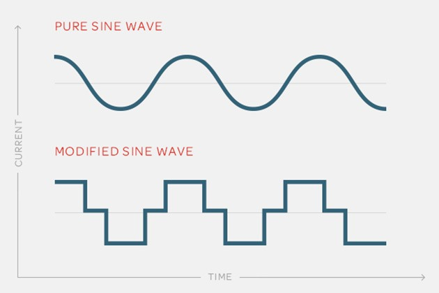

Modified Sine Wave Inverter
A modified sine wave inverter uses an H-bridge circuit and a high-speed switch. In a modified sine wave inverter, DC power is alternated by the H-bridge, while a high-speed switch pulses the current in a way that the average voltage mimics that of sinusoidal waveform AC power. A microcontroller switches the power with varying on-off pulses (called pulse width modulation, or PWM) so that the average voltage at any period in time mimics the voltage one would expect of sinusoidal power in the wave period.
The result of this switching action is a stair-stepped waveform that is much closer in shape to that of a sine wave, but it’s still not exactly sinusoidal. For many applications, this type of AC power is acceptable and can be used with most types of electronics and motor applications.
Comparing pure and modified sine waves
Figure 3. A modified sine wave inverter has the same period and magnitude waveform as pure sinusoidal power, but its shape is constructed from discrete steps. Image used courtesy of The Inverter Store
Pure Sine Wave Inverter
A pure sine wave inverter operates by the same principles as a modified sine wave inverter, however, extra electronic components are needed to further refine the modified sine wave into a wave that closely resembles that of grid power. To achieve this, the modified sine wave output passes through an LC circuit.
A basic LC circuit consists of an inductor (L) and a capacitor (C) that can work as an electrical resonator to smooth the abreast stair steps into a passable sinusoidal shape. The shape of the waveform is like the power produced from the electrical grid. The power produced from a pure sine wave inverter is of a higher quality for sensitive equipment but at the cost of lower efficiency when compared to modified sine wave or square wave inverters.
