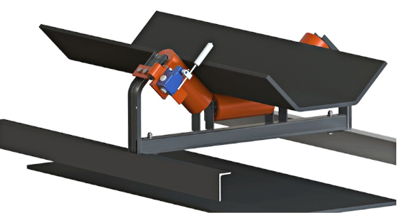

Figure 1. A conveyor belt misalignment switch can be implemented for safety purposes. Image used courtesy of GURTEC
The resulting unsteady belt movement can damage the material, and this condition can be even worse at high speeds and with longer conveyor lengths. In addition, belt misalignment can physically damage the belt, making it unusable for conveyors.

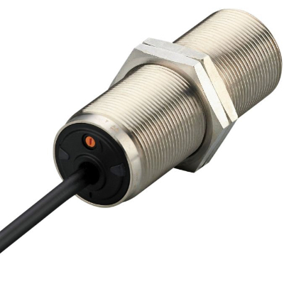

Figure 2. A motion sensor may be able to detect belt slip before it becomes dangerous. Image used courtesy of ifm electronic
The main cause of belt slip is an improper grip between the belt and the drive roller. The tension between the rotating roller and the belt must be within a proper limit to ensure contact is made. Another cause of belt slip is wear and tear in mechanical moving parts, such as pulleys. It can also result from transporting overweight material, which exerts a force on the belt that hinders its movement.

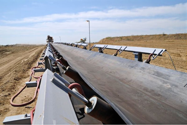

Figure 3. Outdoor conveyors, such as those for mining, may be more susceptible to breakdown.
