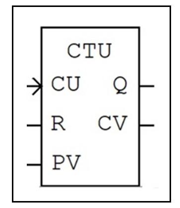

Count Up (CTU) Function Block (FB) Primer
As observed, there are three Boolean (BOOL) data type pins and two integer data type (INT) pins. The BOOL data type pins will react to ON or OFF switch contact events, while INT data type pins are non-decimal numbers. With the pin definition table, the CTU FB tag I/O listing can easily be created for the specific control application.
CTU FB with labeled pins
Figure 1. The CTU FB with labeled pins.

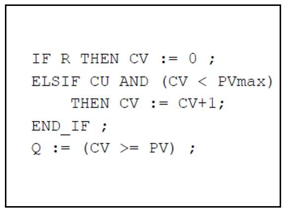

The functional logic behind the CTU FB can be illustrated using the equivalent IEC 61131-3 Structured Text (ST) language format.
STL equivalent programming language for a CTU FB
Figure 2. ST equivalent programming language for a CTU FB.
The ST format explains the operation of the CTU FB in text. The operation of the CTU FB is as follows:
  • If the Reset (R) is activated, the Current Value (CV) is equal to 0.
  • Else if the Count Up (CU) value and the CV are less than the maximum Preset Value (PVmax), the CV value is incremented.
  • The equation used to increment the CV is the counter equation of CV +1.
  • The CTU FB will end the counting event when the CV is greater than or equal to the PV. When the conditional equation is true, the CTU FB output (Q) is turned on.

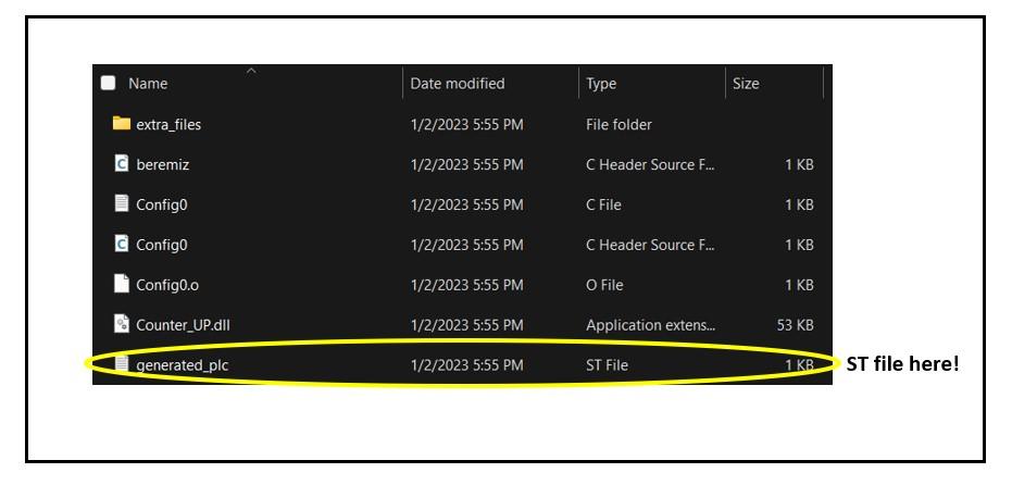

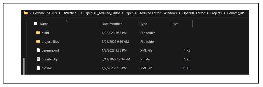

The ST file may be found within the generated OpenPLC file structure of the specified ladder diagram (LD) build folder. Figures 4 and 5 illustrate the locations of the Count Up counter LD application programmed in OpenPLC. The ST file is text-based; therefore, it can be viewed using any notepad or word processing software package.
OpenPLC build folderFigure 4. OpenPLC build folder.
The ST text file locationFigure 5. The ST text file location.

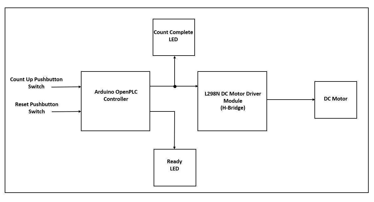

To provide a system architecture perspective of the CTU counter DC motor controller, a block diagram is provided in Figure 8.
Count Up Counter DC Motor Controller Block Diagram
Figure 7. Count Up Counter DC Motor Controller Block Diagram
As illustrated in Figure 7, the enhancement made to the Arduino OpenPLC is the L298N DC motor driver module. This electronic control module is capable of operating two DC motors independently. Figure 7 illustrates that one control signal is required to operate the motor driver. Therefore, the module can easily be wired and operated using the OpenPLC simulator.

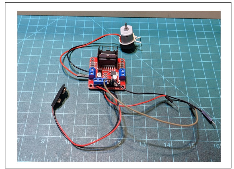

Preparing the L298N module consists of electrically attaching it to the Arduino, the DC power supplies, and a small DC motor. Figure 9 provides an electrical wiring diagram for attaching the 9 V battery, a +5 V DC voltage source, and motor to the module.
The L298N DC Motor Module electrical wiring diagram
Figure 8. The L298N DC motor module electrical wiring diagram
An important item to observe is the IN1 attachment to digital pin 7 of the Arduino. The Arduino will provide a digital control signal voltage of approximately +5 V to the L298N H-Bridge device. Upon receiving this control signal voltage, the L298N integrated circuit (IC) will turn on the small motor wired to terminal pins OUT1 and OUT2 on the module. Figure 9 shows the complete attachment of the 9 V battery and the motor to the module.
Complete Small DC motor attached to the L298N module
Figure 9. Complete small DC motor attached to the L298N module
Although the 5 V supply on the Arduino board can technically provide voltage to this very small motor, it is good industrial wiring practice to provide electromechanical devices with their own power sources. The demand for such components can exceed the current limits of the Arduino’s onboard 5 V regulated power supply requirements.

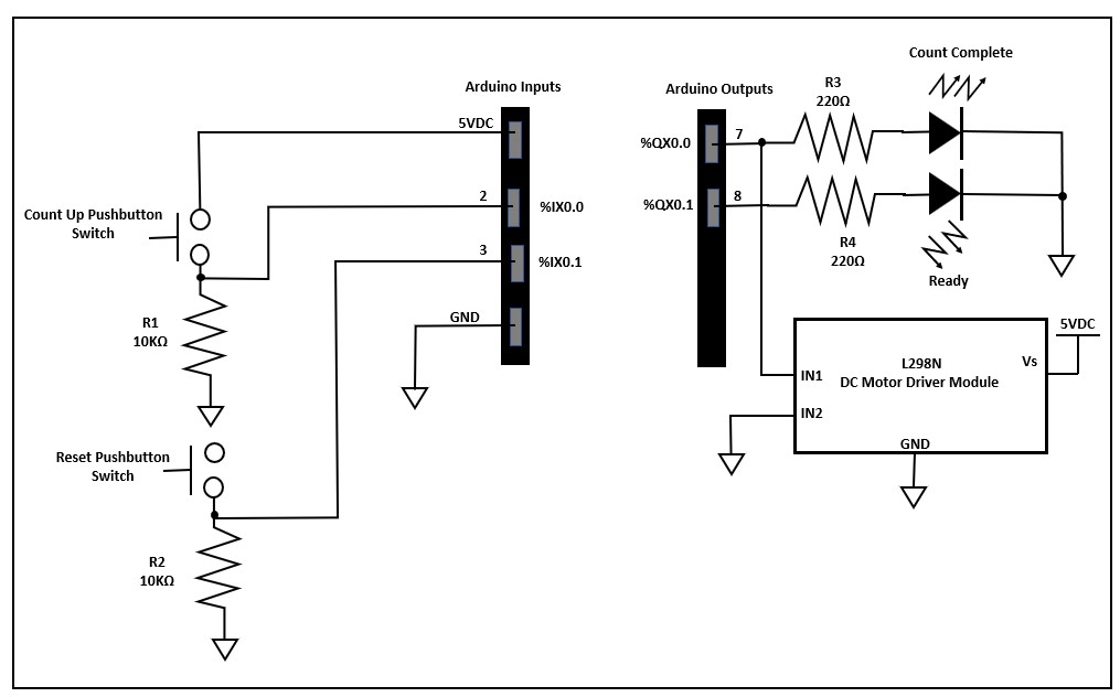

The final step to completing the hardware build is wiring the Arduino OpenPLC controller to the L298N motor driver. The wires that will be connected into the Arduino’s ‘Power’ and ‘Digital’ headers are the +5 VDC Supply, GND, and the Digital Pin 7 leads.
Figure 10 provides an I/O wiring diagram illustrating the location of the insertion points of the two wires to the Arduino female header connector. Notice that the Digital Pin 8 wire is electrically wired to resistor R4 (220Ω) mounted on the solderless breadboard.
The Arduino I/O Wiring Diagram
Figure 10. The Arduino I/O wiring diagram

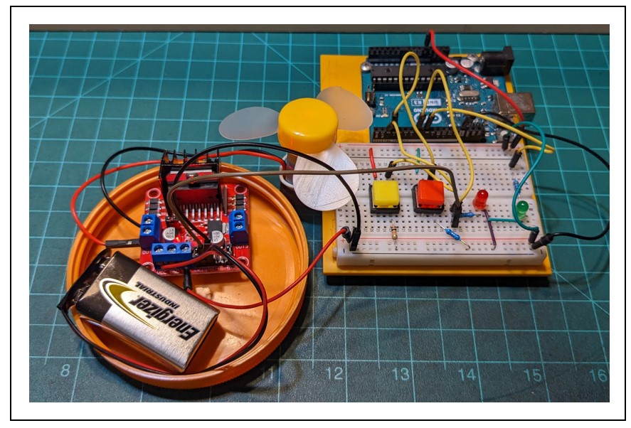

Figure 11 shows the complete build of the Count Up Counter DC Motor Controller prototype. The compactness of the build allows ease of transporting for technical training and demonstration, but you may also design a similar efficient form factor. The other benefit of this build is that another 9 V battery can be attached to the Arduino when the USB power is removed, thus providing an untethered device for education, technical training, and demonstration.
The Assembled Count Up Counter DC Motor Controller
Figure 11. The assembled Count Up counter DC motor controller

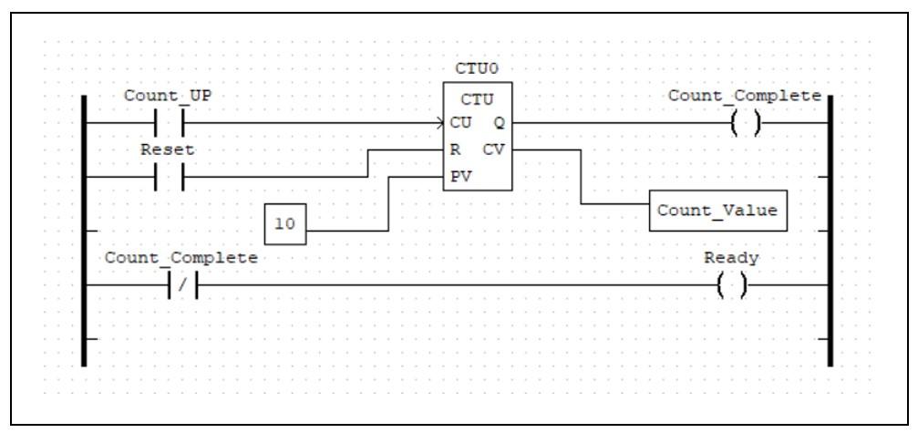

CTU Counter Ladder Diagram

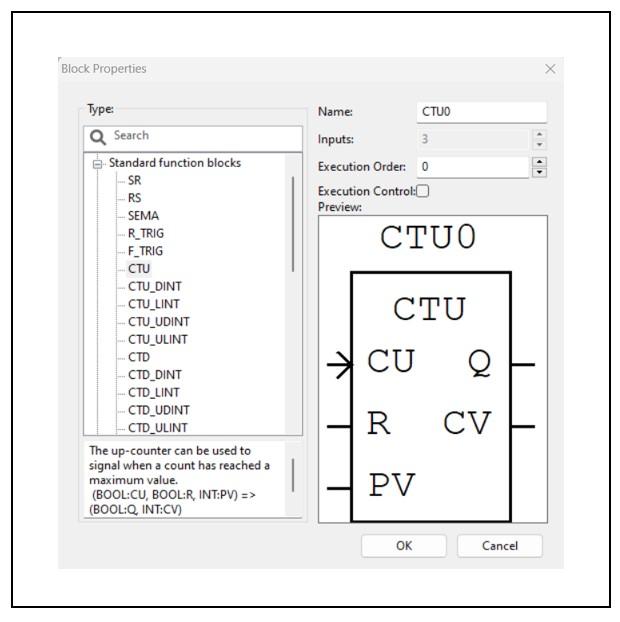

The Count Up software is a generic LD that allows the activation of one pushbutton to increment the CTU FB counter.  The other pushbutton resets the CTU FB counter when the CV equals the PV. To understand the bit instructions and FB components for this counter application, refer to the previous article. The CTU FB counter in the OpenPLC Standard function block library is illustrated in Figure 12.
Selecting the CTU FB from the Standard Function Block library
Figure 12. Selecting the CTU FB from the standard function block library

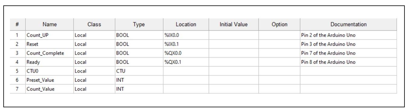

The next step is creating a tag I/O listing, which is explained in detail in the following article. Here is the tag I/O listing for this Count Up LD control software.
Count Up Counter tag I/O listing
Figure 13. Count Up counter tag I/O listing
With the tag listing created, Figure 14 provides a look at the LD for the Count Up counter control software ladder diagram.
The Count Up Counter LD
Figure 14. The Count Up counter LD
Operating the DC Motor Controller
With the CTU LD built, attach your Arduino to your computer using a USB cable. Select the Arduino icon viewed on the OpenPLC task bar. Your control’s development platform monitor screen will display a setup window. Select the appropriate communication (COM) port within the setup window. Select the upload button with your mouse, and within a few minutes, the output window will display Done.
The ‘Ready’ LED will be illuminated. Press the ‘Count Up’ button ten times: the Ready LED will turn off and the motor will turn on while the ‘Complete’ LED will be illuminated.
Pressing the ‘Reset’ button will turn off the Complete LED and the motor. The Ready LED will be turned on.

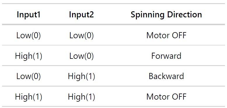

Interactive Quiz
Using the truth table provided, redraw Figure 10 showing the L298N DC Motor Driver Module operating the small DC motor in the reverse direction.
Interactive Quiz: L298N DC Motor Driver Module Truth Table
Interactive Quiz: L298N DC motor driver module truth table
