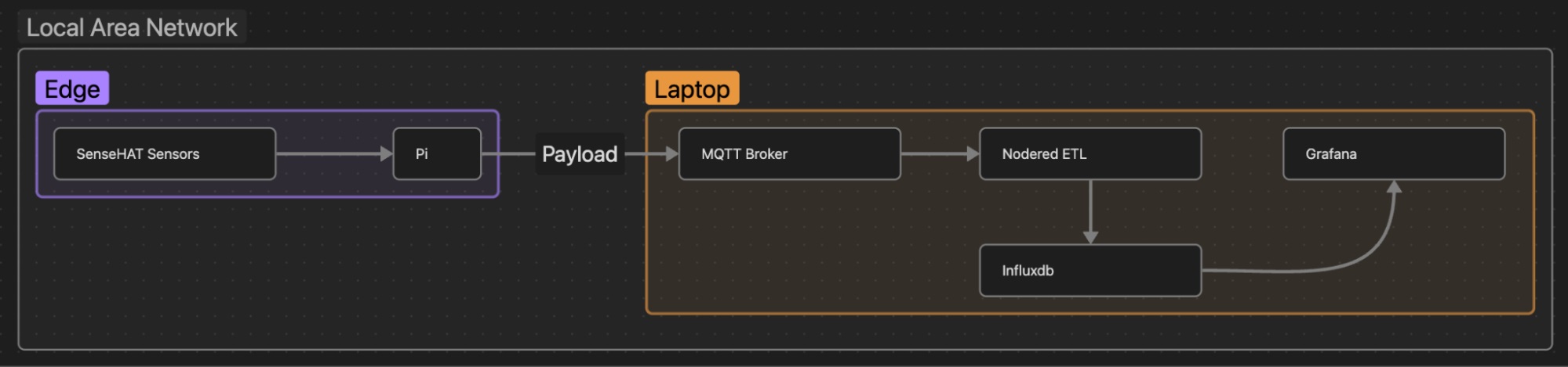

This series will venture into potentially intimidating new territory, such as Docker containers, networking, and databases. If some of these technologies are unfamiliar, not a problem! I personally had not worked with several of the technologies before writing this series, so we are all learning together. A high-level overview of the technology stack can be seen below. Notice the sheer variety of tools required.
The entire technology tree for an IIot project
Figure 2. Tech stack overview. Image used courtesy of the author

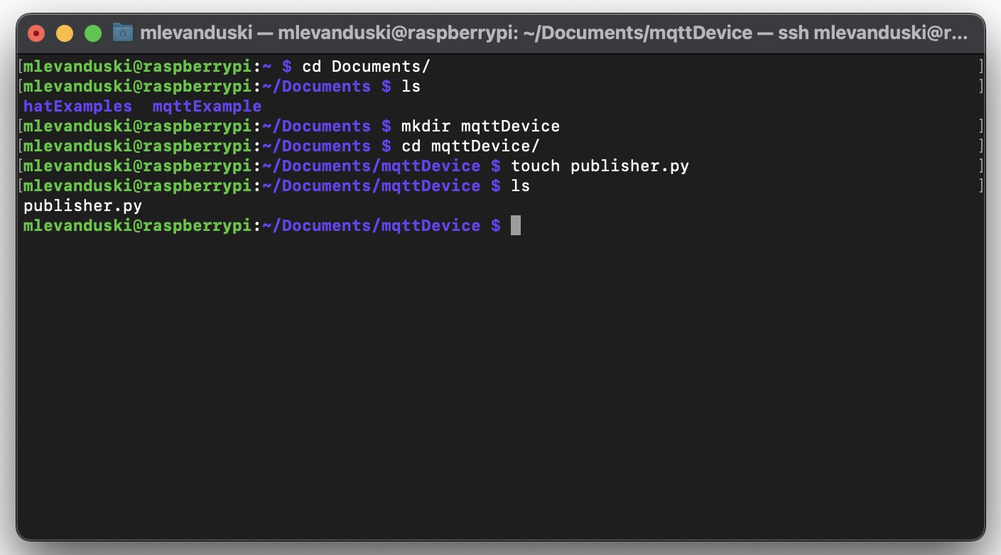

To start, we will use the SSH protocol to remote into the Raspberry Pi. Within the remote terminal, we will create a new directory and a Python file within that directory to house the code for the Pi.
Creating SSH terminal and new directory
Figure 3. Example of a new directory and Python file being created in a remote terminal window via SSH protocol. Image used courtesy of the author
