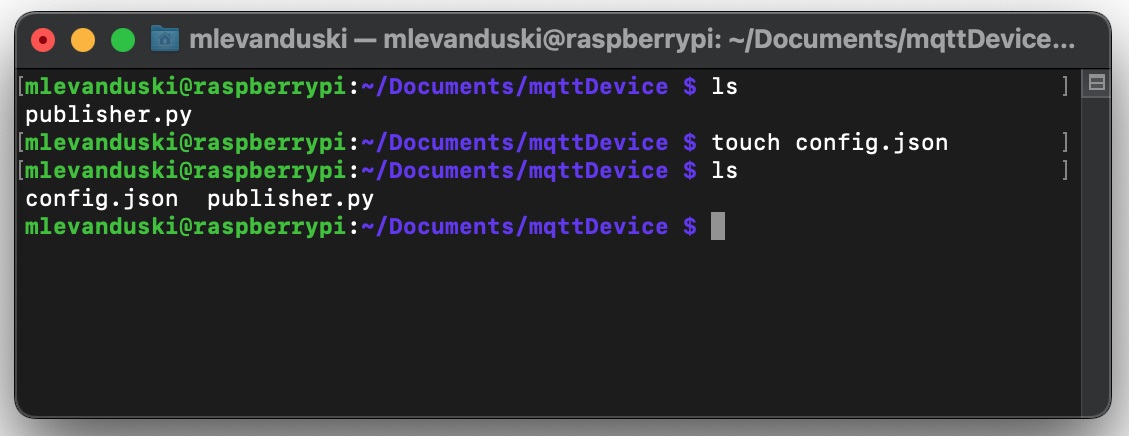

In the parent directory of your project, create another file called “config.json” using the touch command. It should look something similar to the below environment:
Creation of a config file
Figure 1. Terminal output for the architecture of the project directory. Image provided by the author

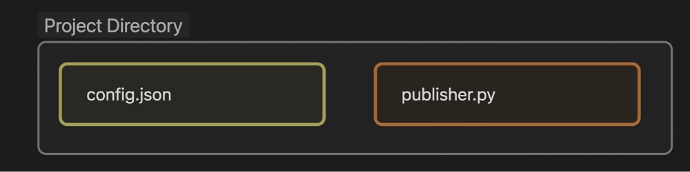

This may not be clear purely from a command line tool, so I’ve provided a complimenting visual architecture diagram below.
Project file architecture
Figure 2. Visual of the architecture for the project directory. Image provided by the author

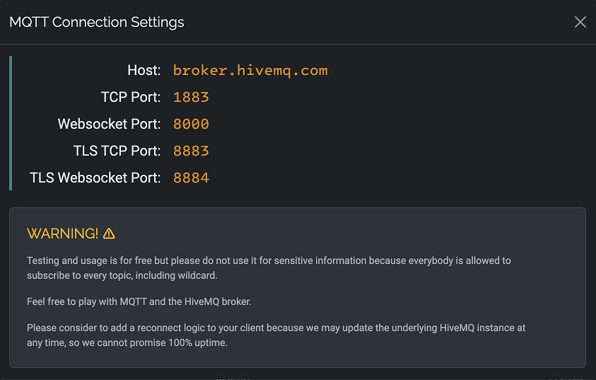

Within the file, we will add a topic and broker key-value pair below. The hierarchical topic can be anything you would like to use.
The broker we will use for our project is a free public MQTT broker offered by HiveMQ. It lacks a few of the security and other advanced features available from some alternative broker services, however, it is a good option for quickly checking development work for hobby project data that does not require security.
"topic": "building1/apt1/livingroom",
"broker": "broker.hivemq.com"
The broker address was obtained from HiveMQ. Please note the security disclosure regarding the broker: do not use this broker for sensitive enterprise data:
HiveMQ security warning
Figure 3. HiveMQ sandbox broker with the security warning. Image used courtesy of HiveMQ

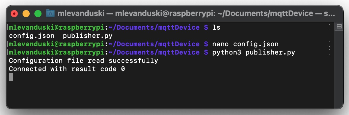

Now that we’ve provided the necessary values to connect the sandbox broker, we can run the publish script (publisher.py) to test. Enter python3 followed by the python script filename we built in part 1. You should see the messages from reading the config file and connecting to the broker correctly:
Running the script to publish a payload to the broker

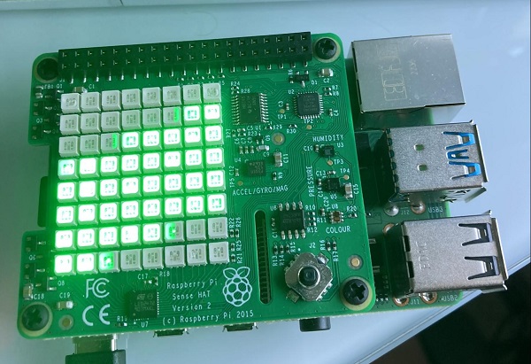

The sense HAT will also flash green 3 times, similar to this static image below:
LEDs indicating successful connection to broker
Figure 5. Successful connection to the MQTT broker. Image provided by the author

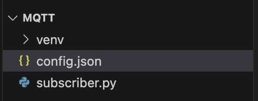

It will use the same config.json file earlier placed in the same project directory as the subscriber.py script. It’s the same architecture of the solution on the Pi, just mirrored on a local subscriber machine. A view of what the folder structure looks like locally in an editor such as VS Code can be found below.
Local project folder structure
Figure 6. Folder structure for the local project. Image provided by the author

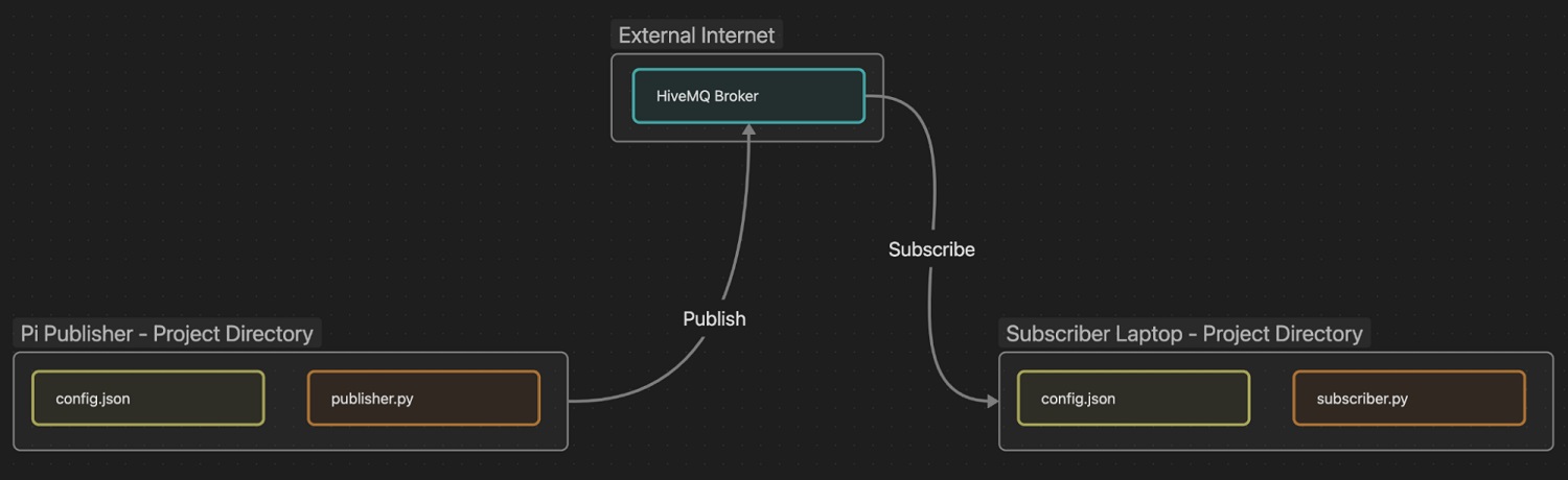

Thus, we’ve created a subscriber out of our laptop and a publisher out of the Pi, utilizing a cloud broker to facilitate communication. A visual representation of the sandbox test environment is below.
Current IIoT project system block diagram
Figure 7. Block diagram representation of this system. The Pi is publishing the payload data to the broker, the laptop is subscribing (reading) the payload from the broker. Image provided by the author
