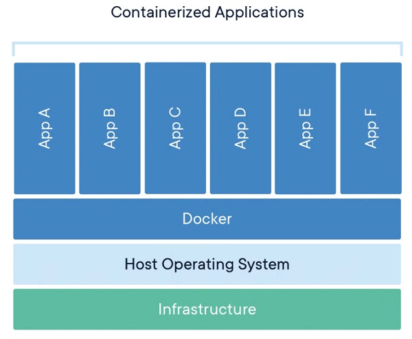

Docker is a containerization platform. It bundles an application’s code and required dependencies into an image that can then be run as a container on a host machine. In a way, you can think of Docker as a digital parasite. It consumes the resources of the local machine to run containers (apps), but each container is, in essence, its own separate program.
Docker containers are not the same as virtual machines, as the Docker platform is running on an actual Linux-based system. A key concept to understand is that containers are ephemeral, meaning that once they are stopped, data does not persist by default.
The concept of 'containerization'
Figure 2. Docker containerization at a high level. Image used courtesy of Docker

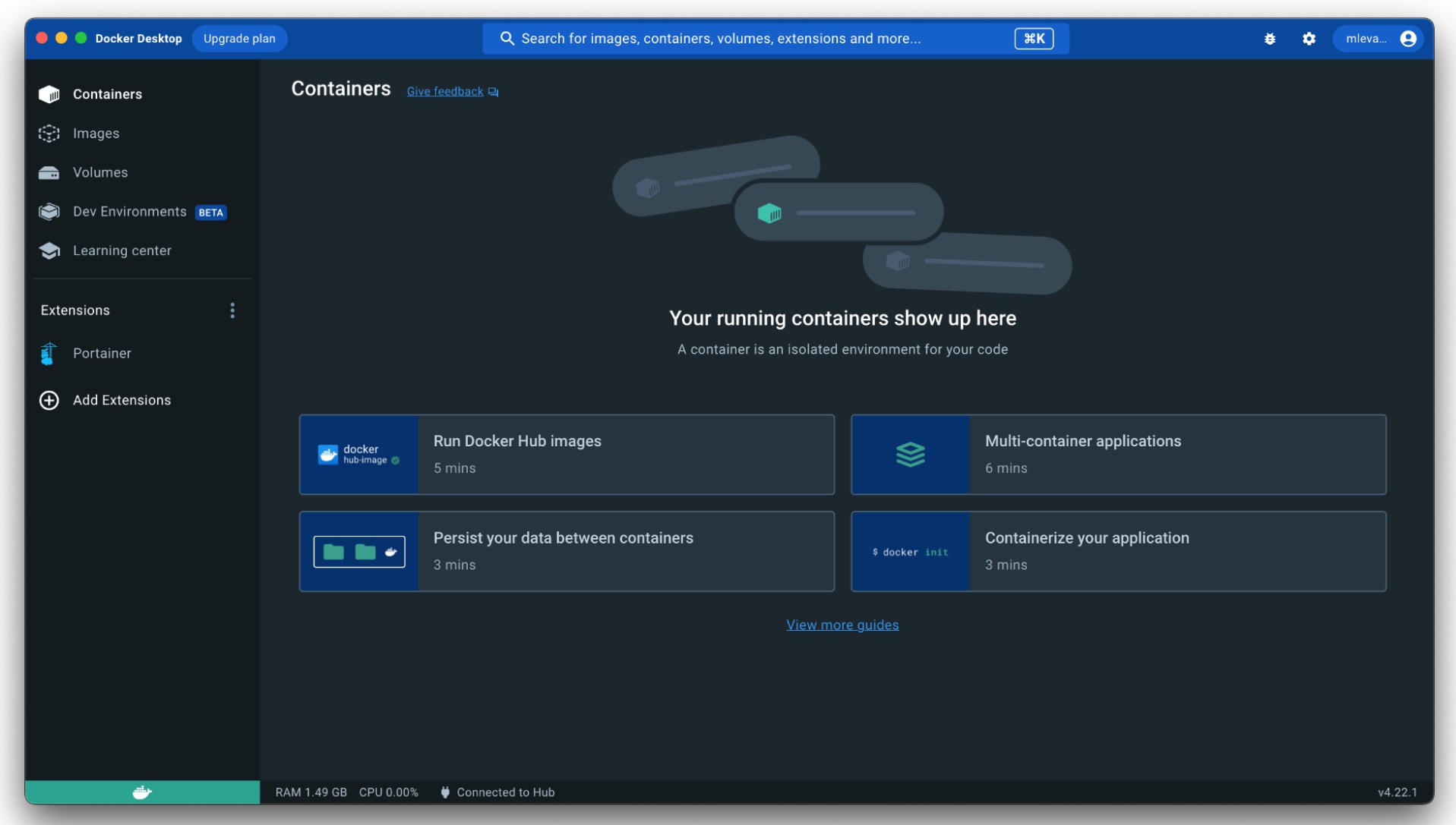

Given that the Docker platform is Linux-based, we will unfortunately need a single install for Docker to run on a Windows or Mac machine. The installation is straightforward, and you may follow along with the provided documentation. If you are on a Windows machine, an install of Windows subsystem for Linux will be required. Once installed, boot up the application so that the docker engine runs on your machine. The startup window should look similar to Figure 3 below.
Desktop user interface for docker
Figure 3. Docker Desktop user interface. Image used courtesy of the author

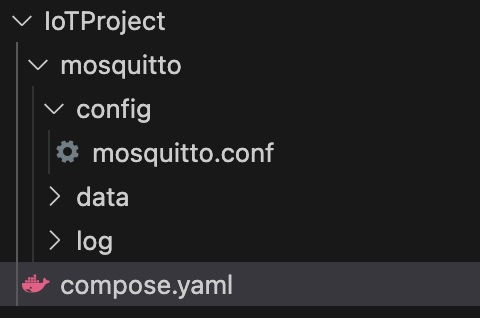

A quick visual of the folder tree created in the IDE thus far is given below:
File system tree for the current IIoT project
Figure 4. IIoT project folder tree. Image used courtesy of the author

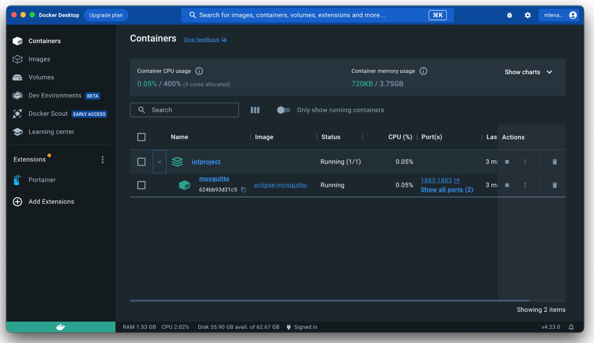

The terminal output is consistent with the Docker Desktop UI:
Graphical user interface (UI) for Docker
Figure 5. Docker Desktop user interface. Image used courtesy of the author
