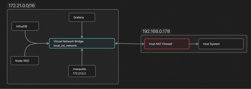

Each container that we provision in this series will be attached to something called a private virtual network bridge. A virtual network bridge can have one or many containers attached to it, and multiple virtual network bridges can exist. Furthermore, a single container could also be attached to multiple networks–or even to none of them at all.
A best practice is to have only one virtual network bridge per application. So in our case, each of the containers in our IoT tech stack application will be connected to the local_iot_network we created in the Docker Compose file of part 3.
Virtual network bridges to the local apps
Figure 1. A visual representation of containers attached to the local_iot_network.
The virtual network bridge is attached to a NAT (network address translation) firewall on the host system IP. This allows us to link the container's private IP addresses to the host system’s IP address using the virtual network bridge.

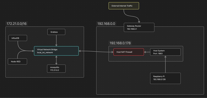

An important concept here is that since each container will share the same host system IP address, the ports on which they are mapped need to be unique. The virtual network bridge running within docker on the laptop or local system does not share the same IP address as the local system. For example, on my system, the two networks are different and even have different notations (CIDR vs. traditional IP address):

So why is there a NAT firewall being used to link the private IP addresses of each of the containers to the local machine? This is where port binding comes into play.
At this point, we have only provisioned the Mosquitto broker with a private IP address of 172.21.0.2 as shown above in Figure 2. In the Docker Compose file, we created port binding in the ports element below:
ports:
- 1883:1883
- 8883:8883

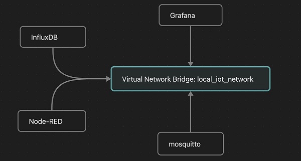

This follows the same HOST:CONTAINER convention as volumes. Therefore, the NAT firewall and port binding allow us to map the Raspberry Pi traffic hitting the local machine, our laptop, to the Mosquitto broker within the virtual private network. An important concept here is that since each container will share the same host system IP address, the ports on which they are mapped need to be unique. For this reason, ports between the container and host machine do not need to have the same numeric value. An overview of the preliminary solution is below:
Binding the devices to network ports
Figure 3. Port Binding and network packet flow from Raspberry Pi to Mosquitto broker.

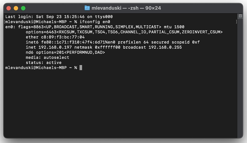

Now that we have the general high-level concept of how the integration will occur, let’s implement! To start, we need to retrieve the IP address of our local machine. This can be accomplished with ifconfig en0 on a Mac or ipconfig on a Windows machine.
ifconfig retrieves the IP address on a MAC
Figure 4. Using the ifconfig en0 command to obtain the IP address of the local machine (is ipconfig for a PC).

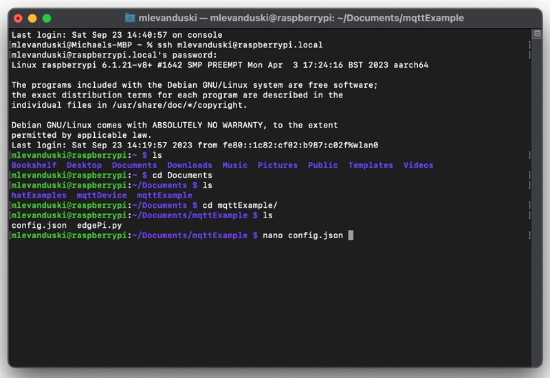

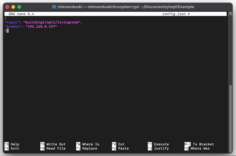

We will then use the SSH protocol to log in to the Raspberry Pi and update the config.json file with the IP address of our local machine. Remember, the port forwarding of the MQTT payload to port 1883 will bind to the Mosquitto broker container attached to the virtual network bridge. Navigate to the config.json file and utilize the nano editor to update the broker IP address.
Navigating to the json file to update the IP address
Figure 5. Navigating to the json file in order to update the IP address of the local machine.
Within the nano editor enter the IP address of your local machine and save the changes:
Updating the IP address in the json file
Figure 6. Actually updating the IP address of the local machine on the Pi.
With the configuration changed to match our Mosquitto broker, running the Python publisher script should yield a connection.

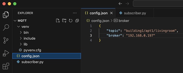

Similar to the step we used in part 2 of the series, it would be great to verify whether the payload is arriving at the broker end. Thus, we will recycle the subscriber script and subscribe to the local Mosquitto broker. Similar to the Pi, update the config.json file for the host system’s own IP address.
Updating the local json file with the correct IP address
Figure 7. Updating the IP address of the local machine in the local system’s own json config file.
